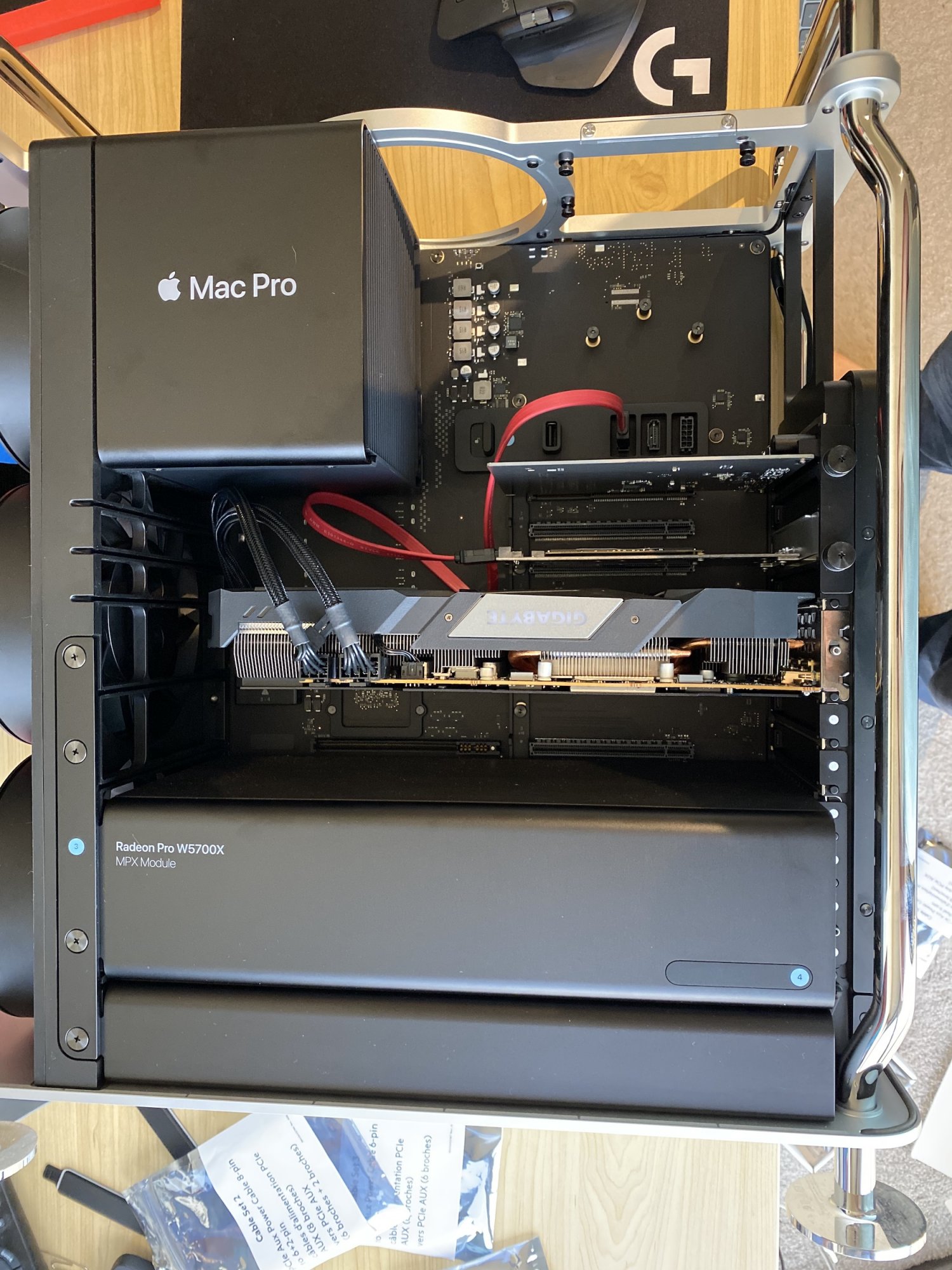

Now that my Mac Pro is finally here, I've begun kitting it out. Installed my SSD PCIe card and 96GB OWC RAM kit which all looks to be working well. Got a dual 2.5-inch SATA Sedna PCIe card coming later today, will pop my 1TB Win10 gaming drive in there.
I'm coming off a homebuilt system that I upgraded a bit over 6 months ago with a Radeon 5700 XT OC, and I'm considering adding it to my Mac Pro to augment the BTO W5700X my system has.
Has anyone done something similar?
The alternative is I just sell it off, but if it's going to provide some benefit I might as well buy the Belkin cable kit and throw it in.
My main workflow is FCP X with Canon Cinema Raw Light footage (4K from C200, 5.5K from 1DX III, soon to be 8K from EOS R5).

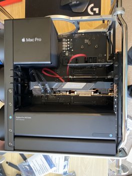

My Belkin cable kit came today but didn’t get a chance to get it installed. Aiming to add my 5700 XT tomorrow arvo.
Doubtful, and besides the electricity usage when idle would be minimal and I don’t think preserving the life on them is really a thing outside of mining rigs.
Give it a try and let us know. That'll be very helpful!

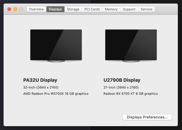

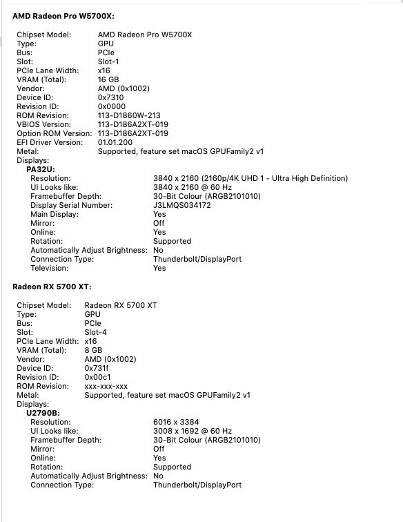

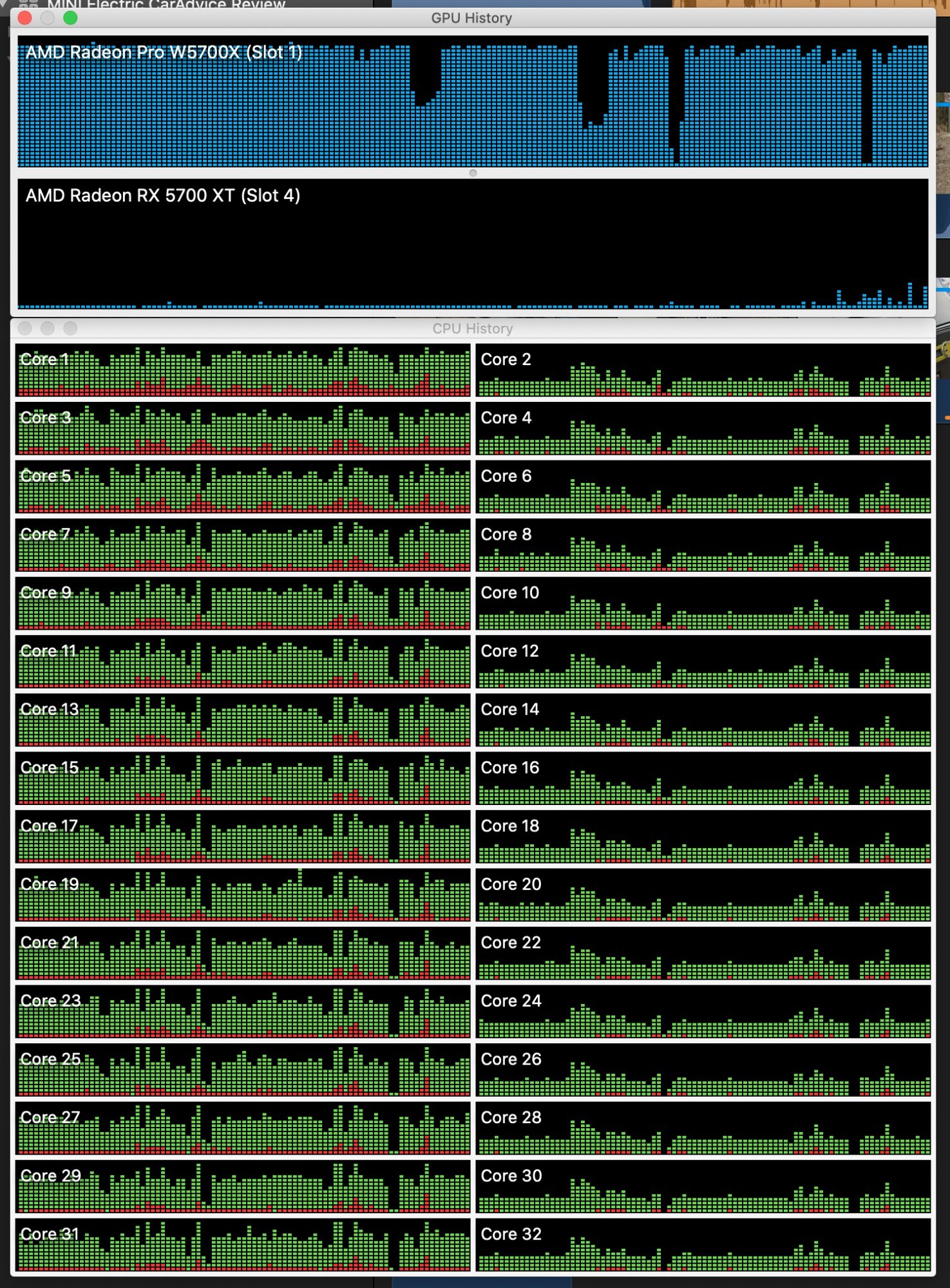

Installed the card this afternoon, and it's working, though not really seeing any boost in FCPX. Background rendering a timeline, I'm seeing good utilisation of the W5700X, but the 5700XT isn't doing squat.
Going to switch to Bootcamp and see if my COD MW problems are resolved using the 5700XT.

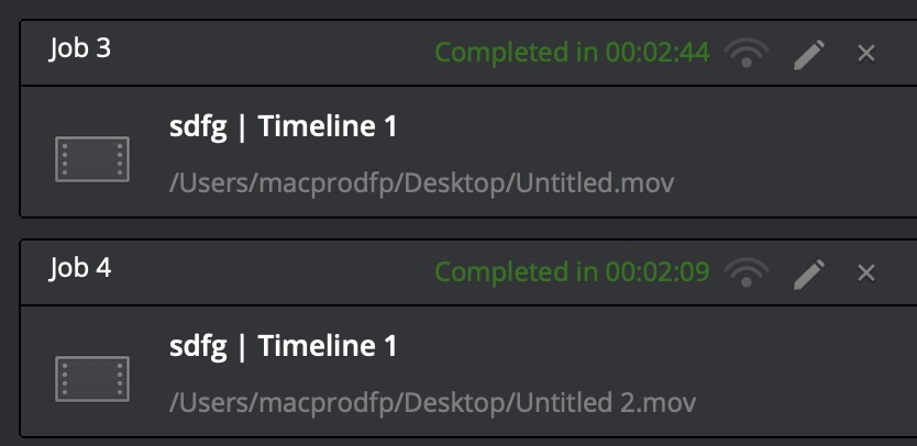

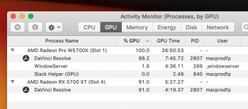

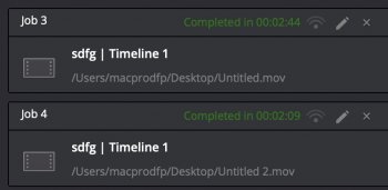

As for making use of the two GPUs, I bought DaVinci Studio today which includes multi-GPU support, and it certainly seems to be working!
Been test exporting a 90 second clip, basically a single ProRes file with some noise reduction applied.
With just the W5700X it took 2 mins 44 sec, and with both it dropped to 2 mins 9 seconds.
