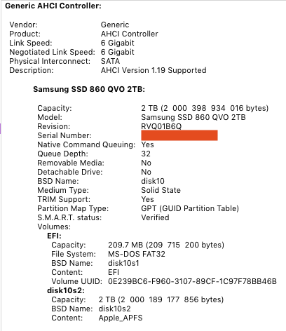

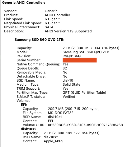

It "works", but KPs frequently. People also reported that it disappears when warm rebooting while connected to the native SATA ports, like the newer SATA high capacity HDDs that have the 3V3 problem.
Another weird thing with these QVO drives, maybe it's inconsequential, but it reports as AHCI 1.19 in your screenshot while most current drives are AHCI 1.30. Last time I saw a 1.19 AHCI version was with Intel ESB2 SATAII from MP3,1.
