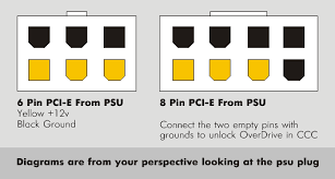

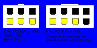

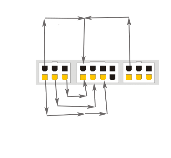

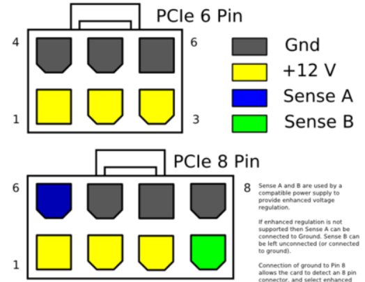

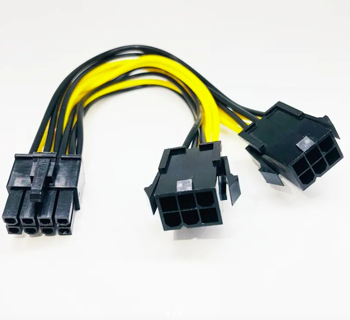

Cr Gott! I've searched 1000 forums. I searched the entire Internet. Please, help. Could someone here on these pages post a wiring scheme for 6×2pins to 1x8 pins. I looked all over the Internet but couldn’t find such a diagram anywhere. It's all very strange somehow.
I'm interested in the scheme for this device.
I watch these pictures, but I can’t understand how to wire 2x6 mini to 1x8 pin???
Many many thanks!!!
Many many thanks!!!
which pin goes where?
