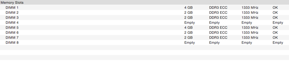

My 2009 5.1 3.46GHz 12-core Mac Pro has slots 1,2,3 and 5,6,7 filled with 2GB and 4GM 1333MHz DIMMs. I'd like to go from my current 16GB or RAM to 32GB of RAM. It looks like installing 8GB DIMMs in the two empty slots would be the most economical solution but I remember reading that filling slot 4 and slot 8 will slow the RAM down to 1066MHz?
If true, would this be a problem or just a slight RAM speed hit?

The CPUs in the cMP use three channel memory. The third and forth slots are wired together to form the third channel. I would put the "2GBs" in the 3rd and 4th slots (7th & 8th) (4GBs for channel 3) Move the 4GB to slot 2 (6) and put the new 8GB Dimm in slot 1 (5). That should keep you at 1333MHz. It's not optimum, but should work out.

I'll give that configuration a try.
