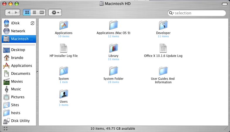

Just install OS 9 first (initalize the drive so it blank), then install OS X right over top of it on the same drive without initalizing the drive. This will put OS 9 and OS X on the same drive. Then when classic starts, it looks for the OS 9 System Folder. The reason you are having the trouble with getting classic to run, is because OS 9 System Folder is not installed. Note in the picture, there is one folder with and X called System (OS X System Folder), then there is another folder call System Folder (OS 9 System Folder). There is also the Applications (Mac OS 9) folder twards the top. If those are not in the root directory of the harddrive, then OS 9 is not installed. I even believe you can install OS 9 after OS X by just going though the install process without initalizing the drive.
