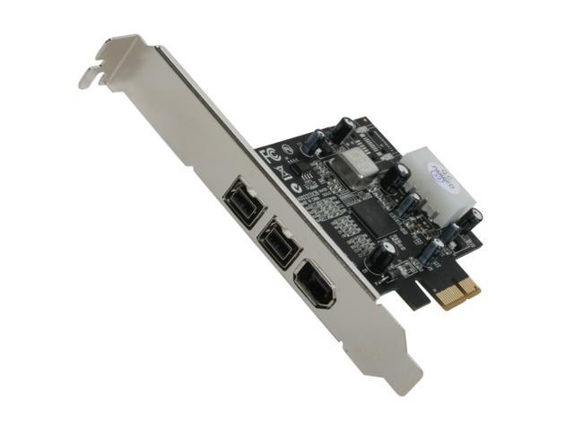

I need advice for adding firewire 800 PCIe fully working on my cMP mid 2010 5.1, because I need more firewire ports.

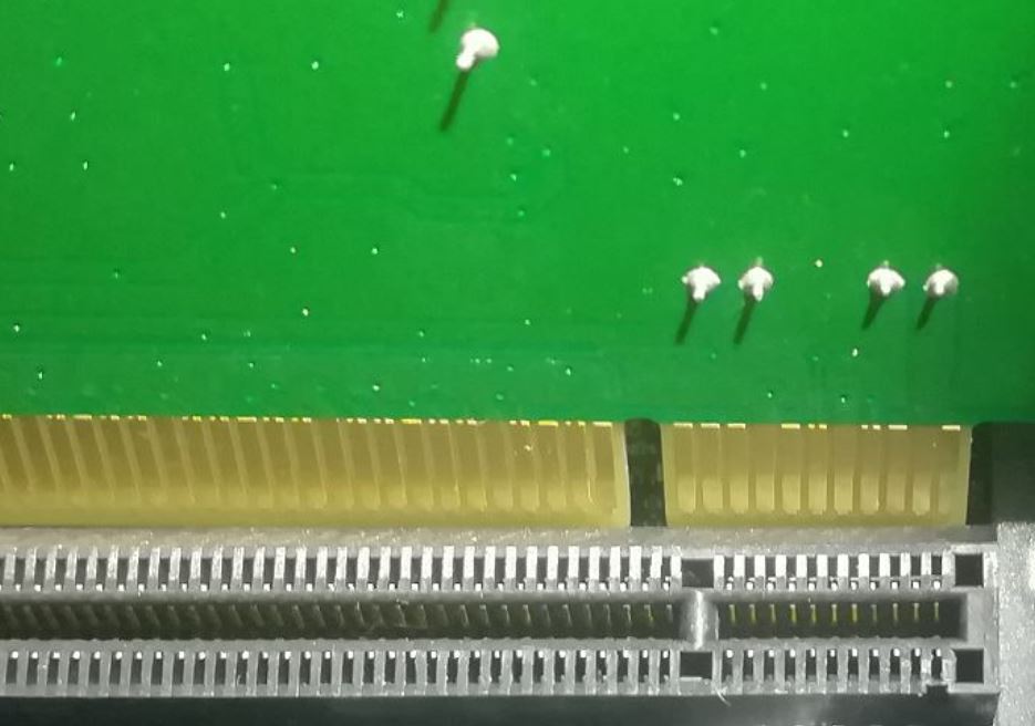

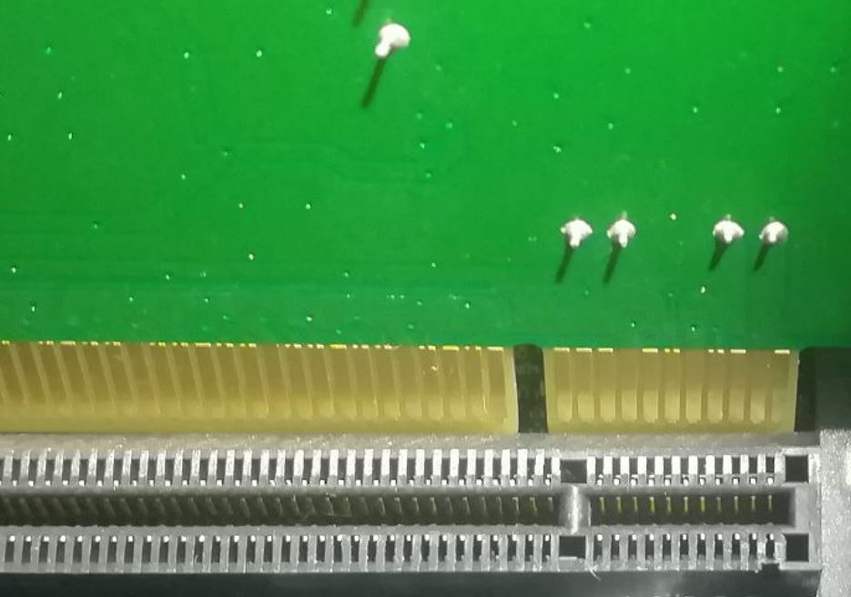

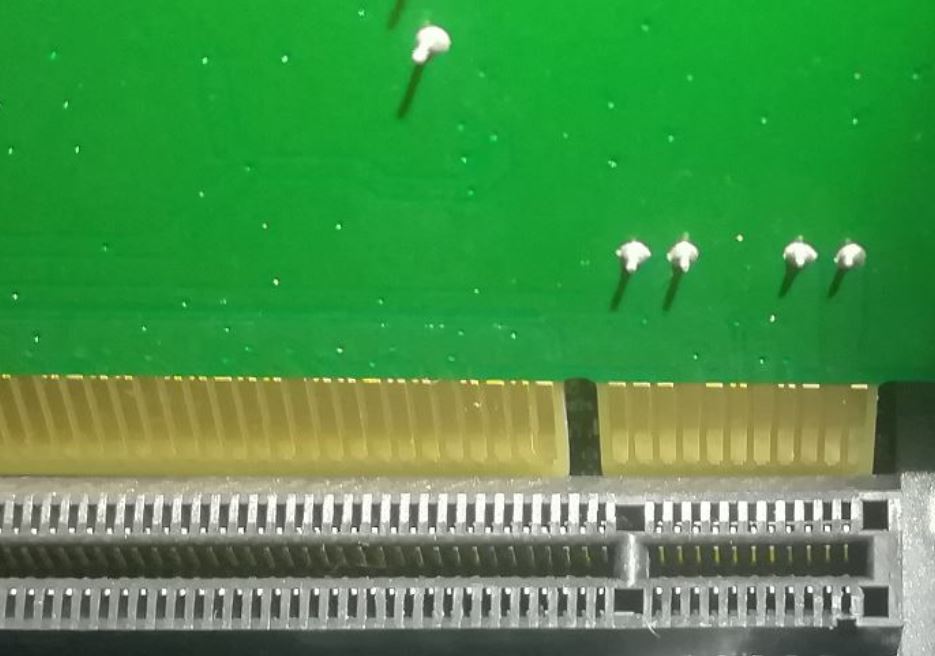

skizzo I need your help please. I have a 2008 mac pro and I need a firewire card since my firebus is not working. bought two already and they were the wrong size fit, and get this. I bought both from Mac resellers and both told me they would work but they didn't fit. Anyhow greatly appreciate your help please on finding one that will fit. THANKS
That's a PCI card (can you show an image of the entire thing?). you need PCIe (PCI Express) card.

I posted the card I bought in #2. I can't recommend anything else since I have not tried anything else.
Thanks for chiming in, the original poster says he has a 2010 Mac Pro. I have a 2008.
Both your 2008, and the 2010 MacPro take PCI-e cards. As pointed out, the picture you posted was of a PCI card, which can't work in any MacPro. The last Macs that could use PCI cards were PowerMac G5, Early 2005 and older.
Post 2 and 3 links for PCI-e Firewire cards should be OK. Not so much demand for those these days, so stock might be limited - but you should be able to find what you need.

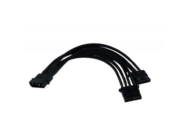

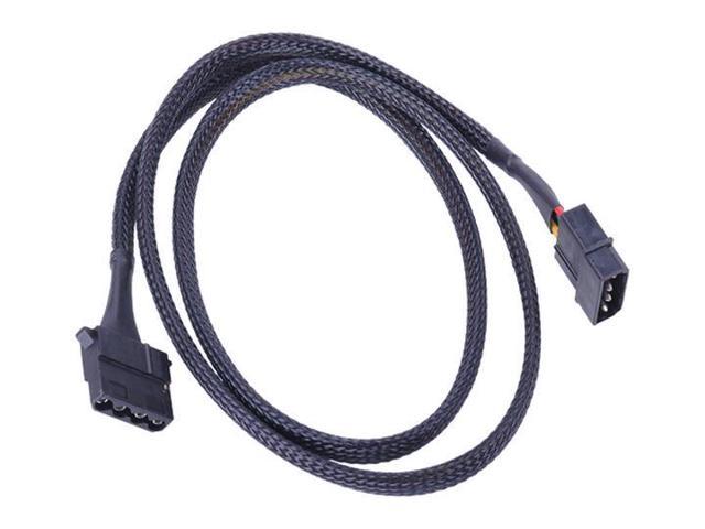

I think any PCIe FireWire card should work. If the card has a power connector like the one I got then you'll want to plan a method to get power to the card using power splitters from the four pin molex connectors in the DVD drive bays or SATA power from the 22 pin connectors of the four hard drive bays. There exists splitters that will let you continue to use DVD or SATA device from the bays.
You can convert between SATA and molex power with adapter - but note that SATA has a 3.3V line that molex does not use or provide (most devices don't require 3.3V). I would choose SATA power as the source for any device with a SATA power connector just in case it uses 3.3V though.

I said using power splitter will let you continue to use the drives - you just need to mount the drives a little differently (except the DVD drives can stay where they are - there's room enough there to split the molex power).
