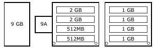

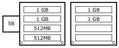

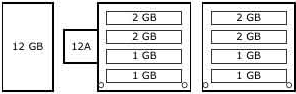

Put your largest ram sticks on the top riser in slot 1 & 2. Then move to bottom riser slot 1&2. Then move back to top then finally back to bottom. you want your largest sticks being accessed first then the smaller last.
Billy
