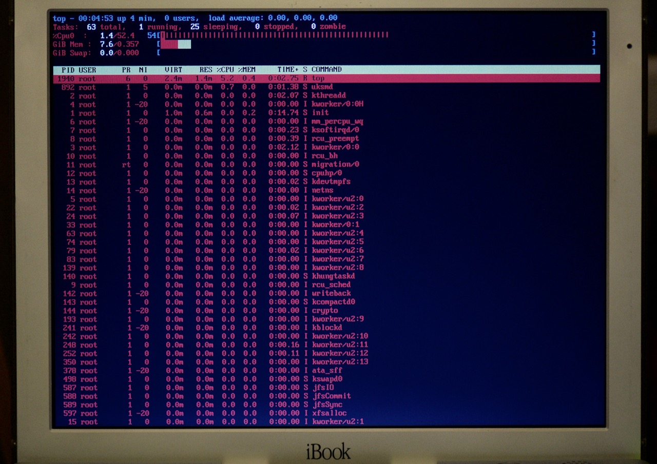

I just booted the Alpha 6 live disc and here's the output of top -o "%CPU"
It shows CPU idling at 54% with no responsible processes.. maybe it is a CPU throttling / sleep process?
Hi AphoticD,
I'm not sure but it seems system time is very high which doen't leave much
for the rest.
When I start up X if pulseaudio is running it goes immediatly to 90 plus percent.
If I stop it it goes to between 70 and 80.
If I look at top when running stuff it looks like it's doing a balancing act between user software
and system but the problem is that no CPU process is using it but usage is still high.
Another thing is because of this total load is always high and cpufreq management with
powernowd is not able to do anything because total cpu is always around 80. The
result is high temps and loud fans :(
I'm trying to get awilfox input on this but she hasn't replied yet.
Best regards,
voidRunner
