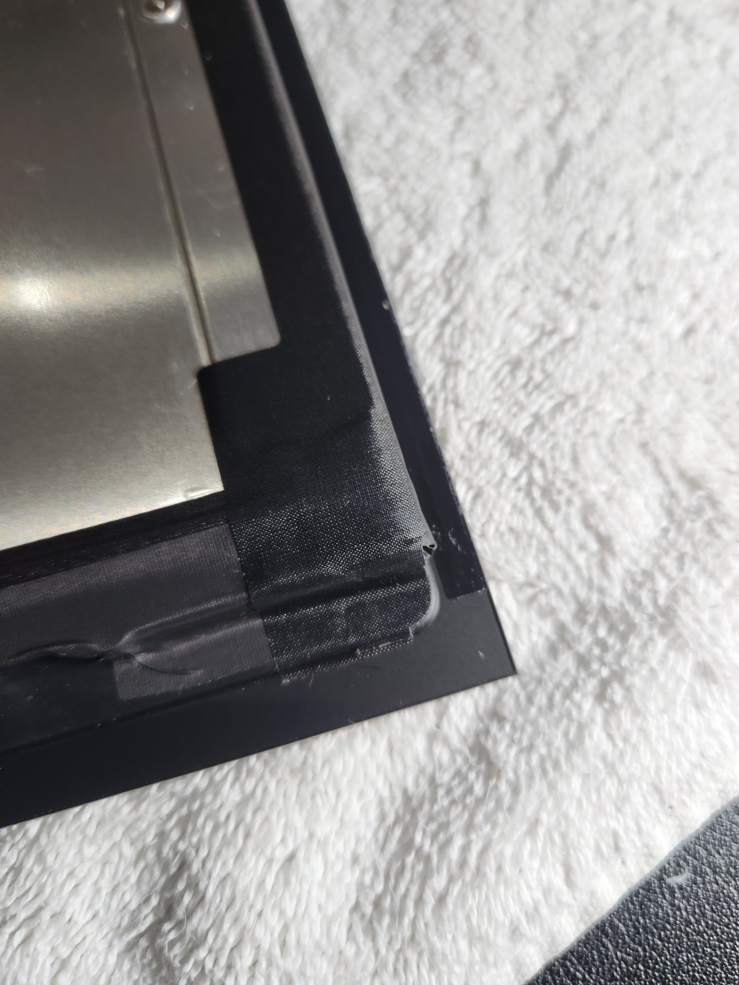

Guys, I know this is an old post. However let mw give it a try.
I am changing ssd on my imac 27 late 2013. Bought kit pizza cutter and strip. I am about to reinstall screen however i saw the screen had like a really thin film attached i removed that and cleaned.. now I am thinking if that thin film is part of screen.. did i just screwed up ?. Picture shows thin film still on screen.. is it ok to remove that or is it just old sticky film previously used .. is used imac and ssd inside was already replaced..
