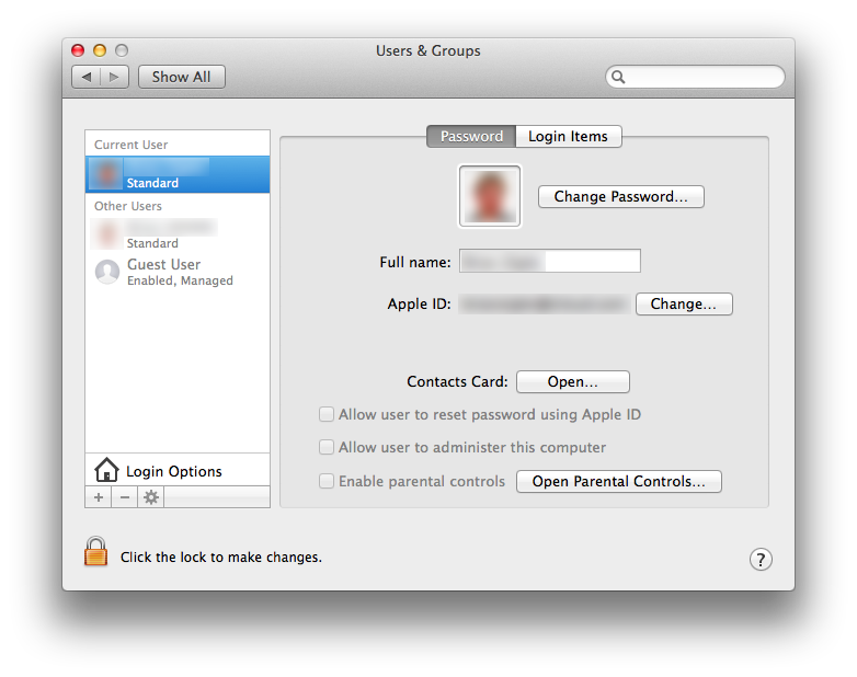

I reinstalled OS X 10.9.4 and when it was finished, I noticed that all of my Admin accounts changed to Standard ones. I'm unable to change any of my settings. How can I fix this?

Very strange. What happens if you click the padlock? Can you open it?
No matter what I do, I can't enter what was previously my Administrator name and password. But the password hint is the one I set for this password.
The problem is, that there's no GUI method to do much of anything, because there appears to be NO admin account, so no simple way to authenticate to fix the issue.

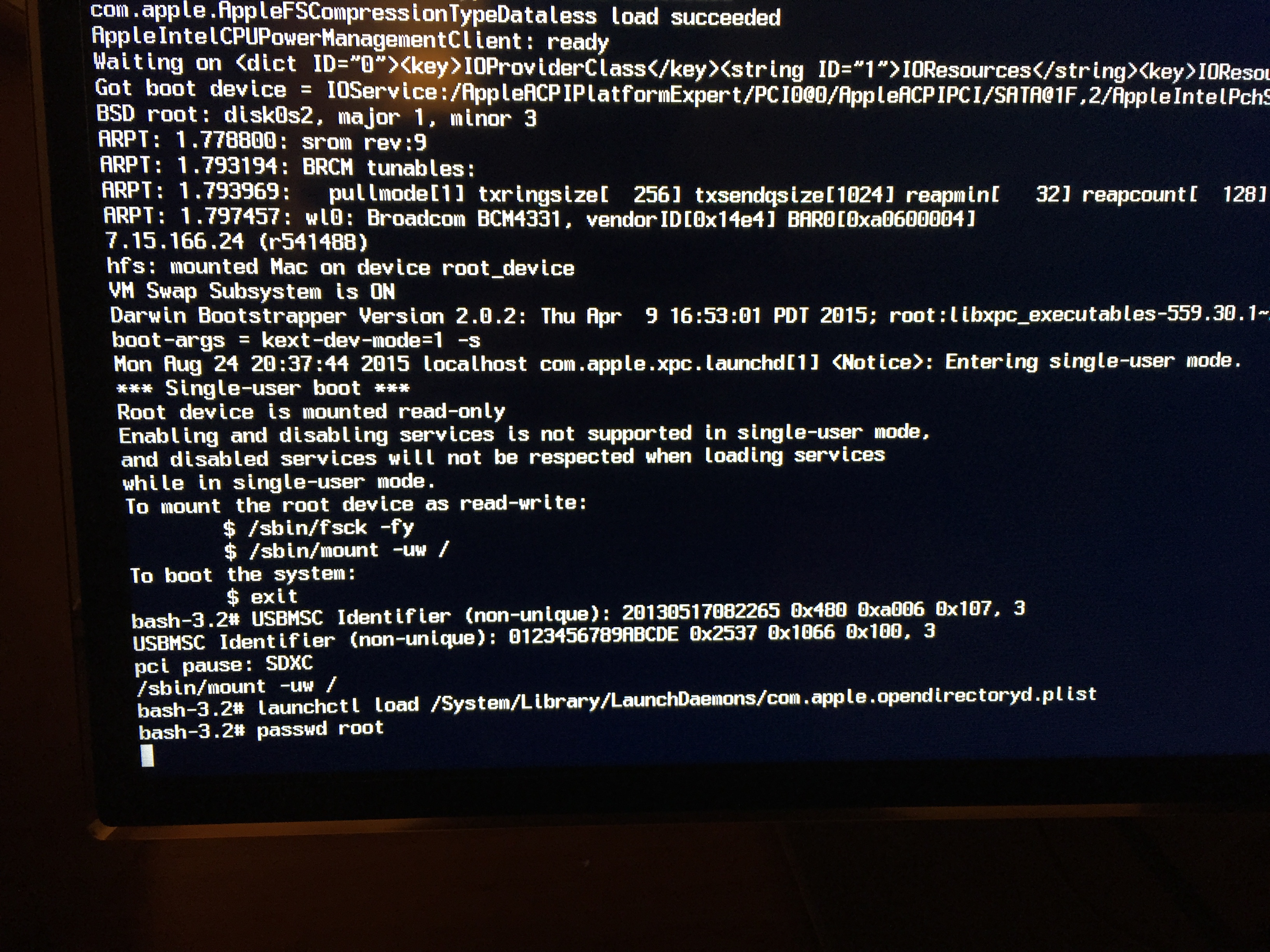

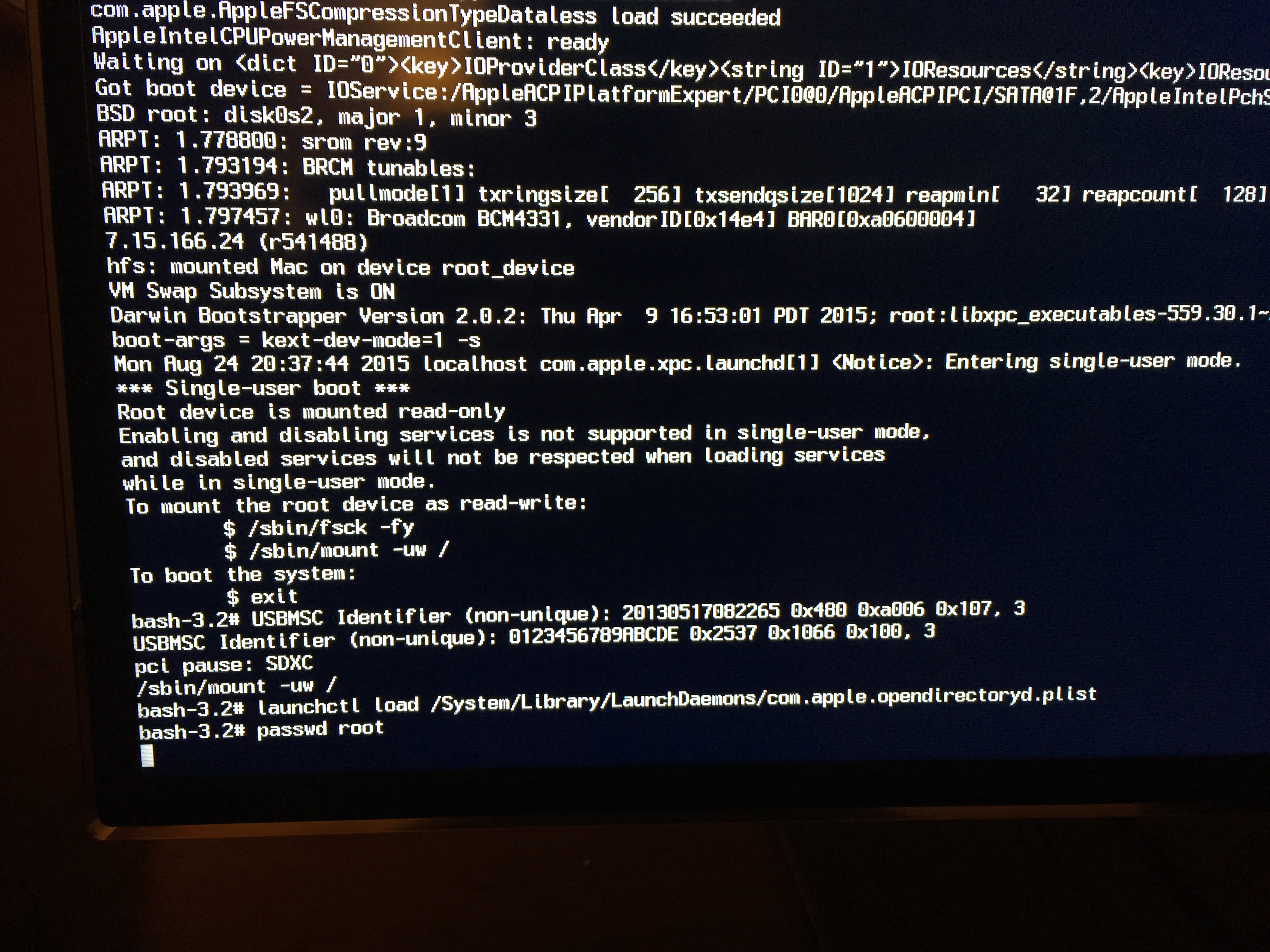

In a moment of complete stupidity I ended up disabling admin privileges on all users. Ive tried the above linked steps and it just stops after passwd root, its been like that for 30 mins... I don't know what else to try
The last command you typed was "passwd root" and the normal response you should have given it was the new password for root, followed by return key and then it will prompt you to type the same thing again (so that there were no undetected mistakes). Then it will confirm that it has changed the password.
Note that when you use the "passwd xxxx" (for any other non-root password) it prompts you for the current password. See the man page for "passwd" command to get the details.
Bottom line, is that it will sit there forever waiting for you to enter something. So give it something to continue the process of changing the password.
