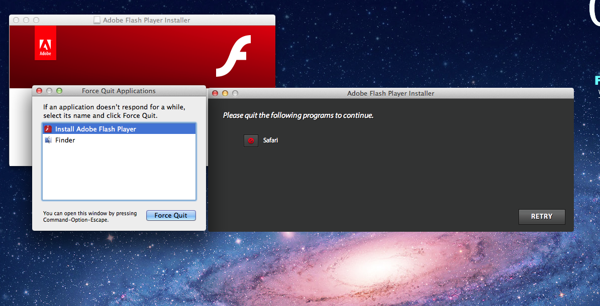

Is anyone having problems with the new update?
I try to update mine and it keeps on asking to quit Safari even if its closed.
Even tried force quitting it, restarting Mac, and none of those worked.
I tried downloading new Flash11 dmg file but still didnt work.
It keeps on giving me that "Please quit Safari before install".
Even after I hit "retry" it gives the same message.
Installation stops around 50%.
Anyone aware of this issue and knows how to fix it?

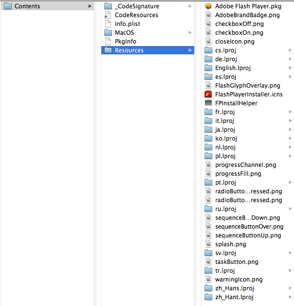

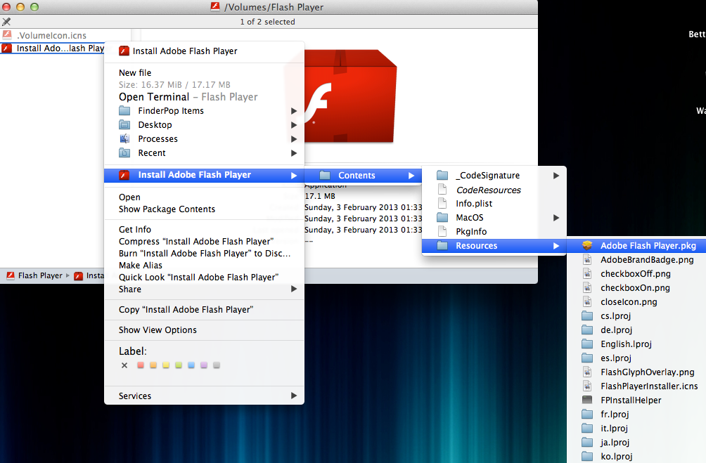

Right click on Flash player>Show Package Contents>go to Contents/Resources>you'll see the Adobe Flash Player.pkg there, open it and if it works.

Screenshot
After opening the DMG and right clicking on the Flash Installer, I have another plugin as you can see which shows the path.

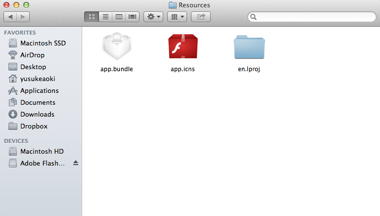

This is all I have under "resources"

I just downloaded the 11.7.700.169 version and it's contents are the same as the version before, go to http://get.adobe.com/flashplayer/
and download manually.
I installed this version without problem.
Im still getting this...
Tried downloading manually as well.
I tried opening it up with "Show package content" yet nothing like yours come up.
Still getting this message.

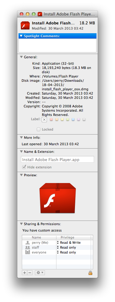

I really don't get it, I included an Info screenshot of the Installer, is it the same as yours, are the bytes exactly the same?
MD5 Terminal output on the downloaded DMG is
MD5 (/Users/perry/Downloads/18-04-2013/install_flash_player_osx.dmg) = 52d572a2803cf667ff21683a941ea1cb
Actually no, my size is 1/18 of that lol

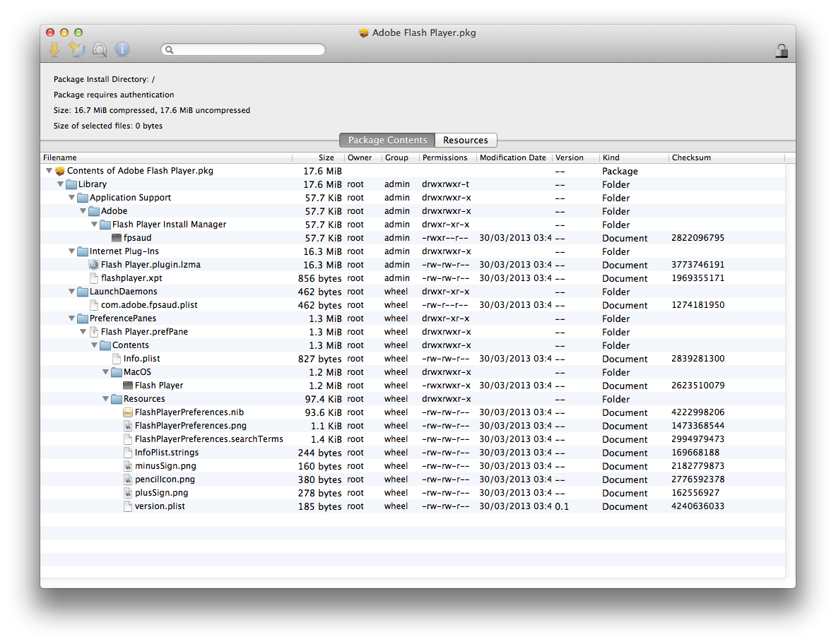

Flash does not install in many places as you can see below, it is easy to backup these files to another Folder, then uninstall Flash and retry.
Several of these files are not really needed, like the fpsaud file and the com.adobe.fpsaud.plist file, these are I think for auto updating.
