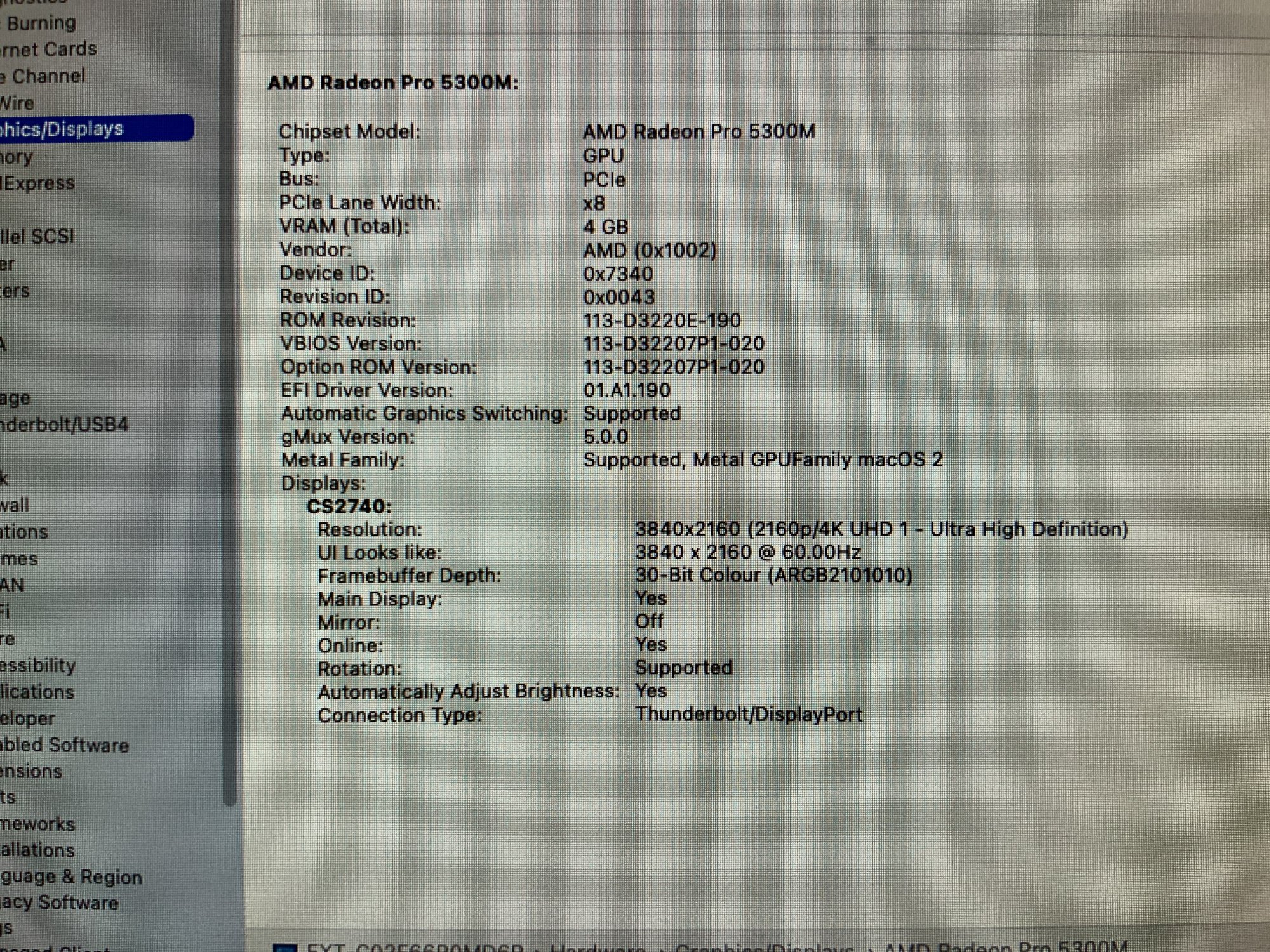

Not sure I correctly understood the EIZO, but it seems when running at 60Hz via the USB-C cable, it can display only 8bit. Only at 59.997 Hz or 30 Hz can display both 10bit and 8 bit.
The MBP seems to output 60Hz. Does this means that connecting the EIZO with the thunderbolt 3 MBP will display only 8 bit? Can the bit setting or the frequency be changed in the EIZO settings ?
I have a CS2740 connected right now to a mbp through USB-C and it runs at 60hz 10bit per channel (the 30bit shown in the picture)
