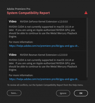

Head's up to anyone using ANY NVIDIA GPU with Adobe's latest software in Mojave. There is a new System Compatibility Report and it will basically autolaunch on startup for Premiere Pro CC 2019 13.1.0 Build 193. If you are using an NVIDIA GPU, you will get this message:
These two lines from the report state:
Video NVIDIA GeForce Kernel Extension v.12.0.0.0
1. NVIDIA CUDA is not currently supported in macOS 10.14 or later. If you are using an Apple-authorized NVIDIA GPU, you should be able to continue to use the Metal Mercury Playback Engine.
URL: https://helpx.adobe.com/nz/premiere-pro/kb/gpu-and-gpu-driver-requirements-for-premiere-pro.html
Video NVIDIA Resman Kernel Extension v.12.0.0.0
IGNORE THE NVIDIA LINKS ON THOSE PAGES - THEY ARE NOT CURRENT VERSIONS

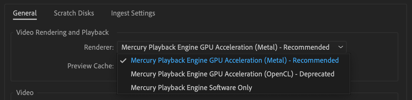

Premiere Pro 2020's render & playback settings clearly label OpenCL as deprecated... thought they were being depreciated, but whatever?
All Adobe 2020 video products also include system compatibility report tools, expanded from just Premiere Pro earlier. The move to Metal on macOS basically needs to be embraced at this point or move to PC.
