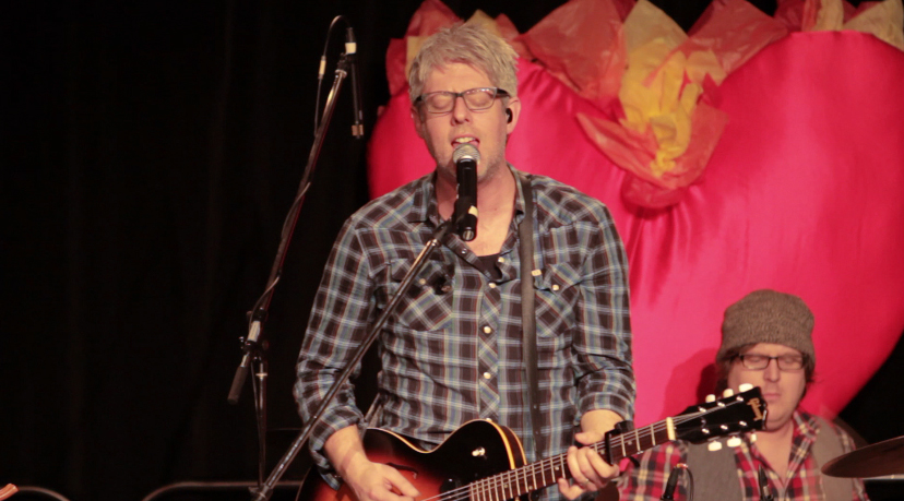

I'm editing this concert and I have a color mismatch on one camera and it's bugging me!
Attached you'll see the main shot which is reddish and the b-roll shot which is the color I want. I'm editing on FCP7.
I also have Color and Magic Bullet Looks but I have only veeerrry basic knowledge of color correction. I tried using the 3-way color corrector in FCP and while I can match one thing, everything else seems to mismatch.
I feel like I need to correct reds, greens, and blues individually, but I don't know how to do that.
Any tips, anyone?
Thanks in advance!

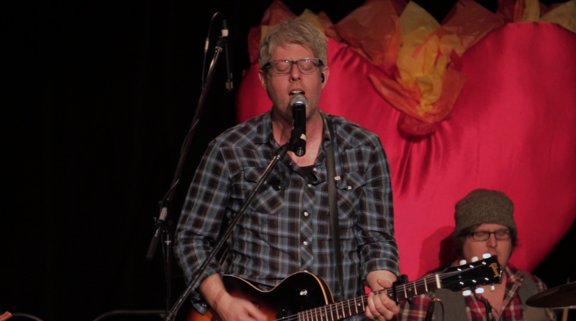

Is this the B-Roll?

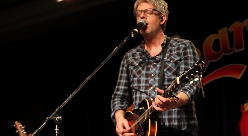

And this is the main camera?

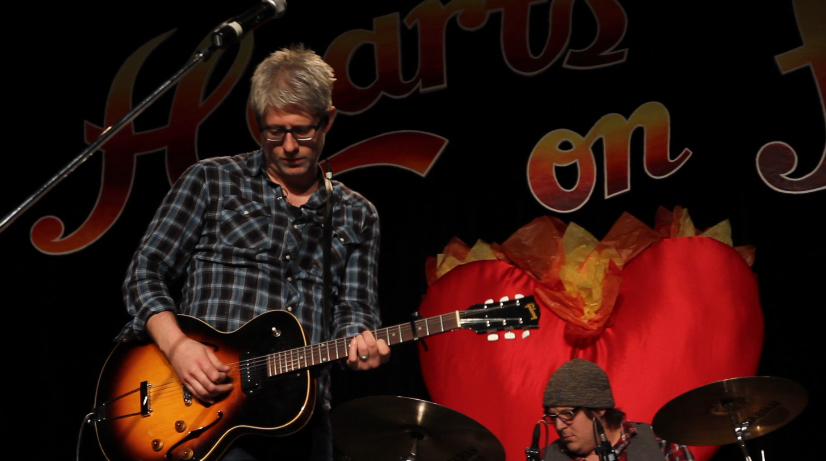

Here's another picture of the "good" shot, showing the heart and a bit of the drummer.

simsaladimbamba, yes you are right with the shots.

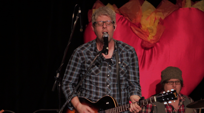

Updated main shot below...maybe as close as it can get?
