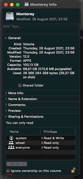

- if you suspect issues with file/folder access, check your external drives through "control+click -> get info"
let me know if any of these helped)
