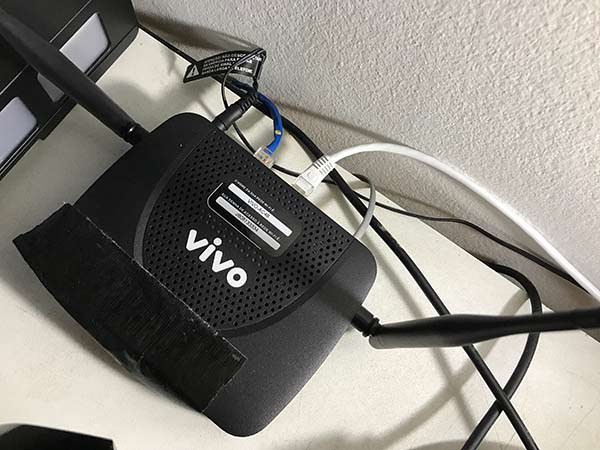

1) My ISP modem. It has wi-fi, but the wireless speeds are poor. That's why I disabled it.

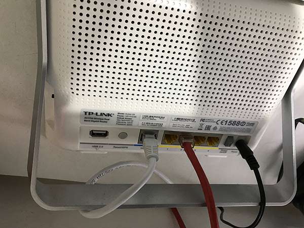

First of all, the Archer C8 has 4 ETHERNET ports, and one port called "Internet".

- PC ----------- Ethernet cable (CAT-6) goes to... Archer C8 (Ethernet port).
- Archer C8 ---------- Ethernet cable connected to "Internet port" goes to..... ISP modem (LAN)

ISP modem:
DMZ is enabled. Private address is 192.168.15.245
Archer C8:

If I do this then I can easily continue using the internet by plugging the ethernet cable to the ISP modem.
The problem is that my PC will stop being visible to the internet, and streaming speeds will be reduced drastically, if I connect to my PC using (for example) the IP 192.168.15.120.

This issue has been solved by doing the following:
1) Connect the Archer C8 router to the ISP modem, using an ethernet cable in one of the 4 "Ethernet" ports from the former, and then in the LAN port from the ISP modem. That means the sole "Internet" port from the Archer will not be used.
2) In Archer internal settings disable DHCP. Also select "Dynamic IP" instead of Static.
3) In Windows 10 input these settings, since the ISP will attribute 192.168.15.X IPs for everyone:
This is required because in the ISP modem internal settings I needed to configure port forwarding to ports 7001-7004, attributed to the IP 192.168.15.141. So that my uTorrent app from PC can download at good speeds.
4) In order to access the Archer C8 internal settings again I need to do step 3), and insert this data instead:
192.168.8.120 (or any other IP in the last 3 digits)
255.255.255.0
192.168.8.1 for gateway
And then in the browser go to 192.168.8.1 to visit Archer's internal settings.
