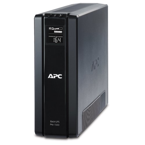

Just some quick background before I get to our current situation. We're a small design studio in a rather old building. From the git-go we've had power issues - tripping breakers, power outages are frequent due to wind/weather - most every piece of hardware that we've had problems with has ultimately been power related - mostly with power supply issues and dead a/c cords with bad transformer boxes.
We have four Mac Pro workstations - they each have their own APC/Back-UPS 750. We consistently have to replace these (usually under warranty), usually due to some power issue zapping the Back-UPS.
Currently we have two Back-UPS that have dead outlets - likely due to a power outage/spike over the weekend. We also lost a Cinema Display as a result, also connected to one of the Back-UPS. So I'm looking to replace those compromised units. I can get these replaced through the warranty - but I'm wondering if we need to switch to Back-UPS PROs equipment. I've been trying to discern the primary difference between the two - looks like the PROs offer Automatic Voltage Regulation.
Does anyone have any experience with these units? Or a similar situation? What do you use for power management/battery backup? Particularly in the case of an old building with fluctuating power issues? Any advice is appreciated. Thanks.

Although the AVR works pretty quickly in the Back-UPS Pro models, for your power situation and expensive equipment situation I would recommend something more capable. Certainly an on-line (double-conversion) system. Basically those run your equipment off the battery all the time. There isn't a delay when switching to battery, and the power is fully regulated and the waveform shaped by the UPS.

Well, it sounds like we should at least look into the Back-UPS PRO. When it comes to power side of these things I know just enough to be dangerous. FWIW, we're also getting ready to go through a bit of a remodel - so we will get an electrician in here to see if there are any economical steps we can take from that perspective - a whole re-wire is out though. That is one reason I hate to put a heavy investment in something like the APC Smart-UPS 750VA if the PROS will suffice. Would it be unwise to put two workstations on the Smart-Ups? Then we could by two Smart-UPS instead of four PROS.

I am using an APC UPS BR-1500 VA for my classic tower Mac Pro http://www.amazon.com/APC-BR1500G-B..._sbs_pc_1?ie=UTF8&refRID=14A7GTGNN313VDKA2VAS
This model has a built in AVR and more important a Surge Protector from electricity spikes and thunderstorms/lightning. A technician told me that lightning may cause damage specially when using the internet that may fry the motherboard.
