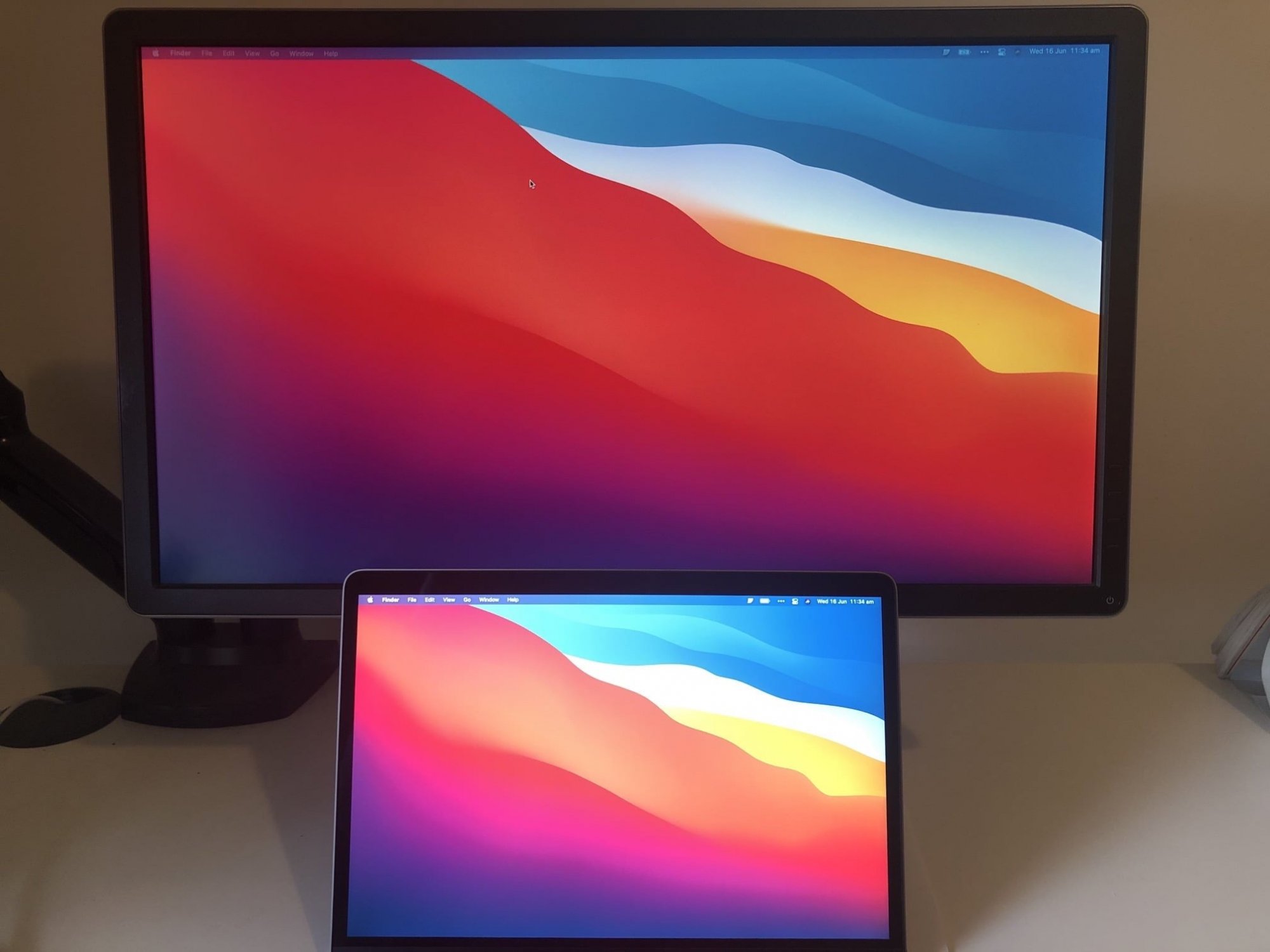

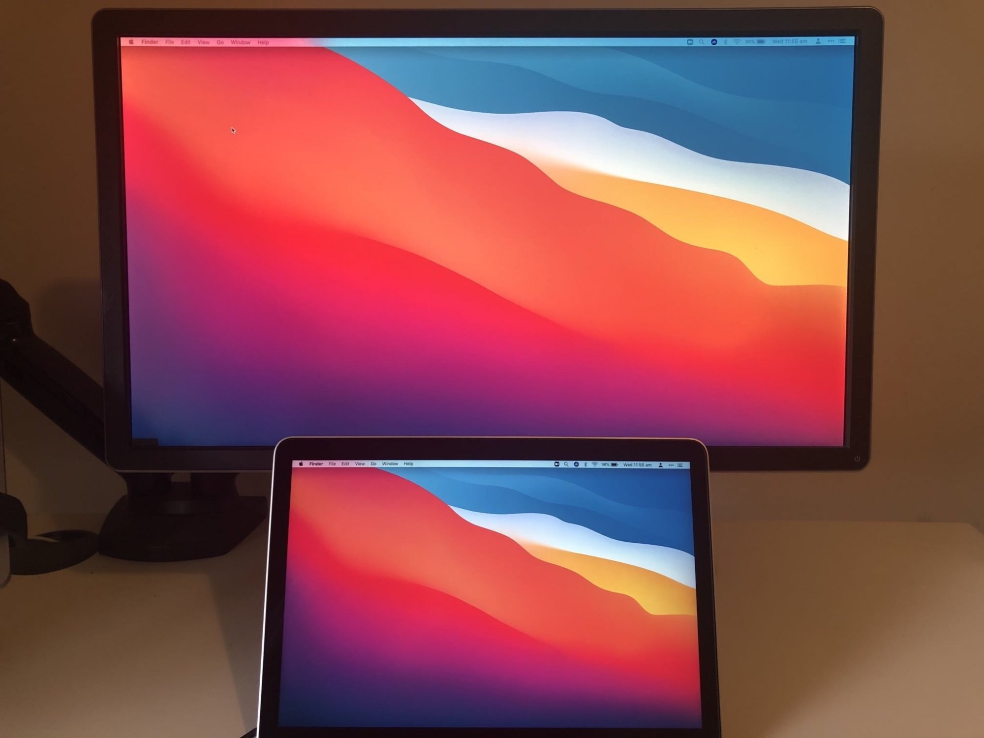

Dave, do you find that the colours on your Dell are very different when driven by your M1 MBP vs your 2015 MBP?
The colours are markedly darker and redder with the M1 vs my 2015 Intel.
I ended up purchasing the Choetech USB-C to DP cable I mentioned, and wonder if the cable can possibly influence colour reproduction? In all other ways it works well — everything's the usual 4K sharpness and at 60Hz.
Here's a couple of photos to illustrate.
2015 Intel driving the Dell: the colours are more closely matched.
M1 driving the Dell: the colour variance is very obvious, with the Dell being generally darker and redder to my eyes.

Looks like the difference between RGB and yCBCR - what does the monitor menu show?
Nothing can be determined, the viewing angle is obviously different between the two pictures and the screen brightness is higher on the iOS device in the second one.
