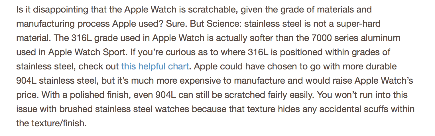

Lol. I *am* a metallurgist, and no, sorry, 7000 series aluminum isn't harder than 316 stainless steel. Rockwell B hardness for 7000 series is about 87; for 316L it's about 95.
There's a joke among metallurgists about aluminum. We call it "shiny plastic".
Well, it wouldn't surprise me if the articles that said that were wrong. Sometimes journalists just make stuff up. 9to5mac said that in their article about the $5 polish.
BTW, 87 for alum Vs 95 for steel is pretty good.
Here is a screenshot from the 9to5mac article regarding scratches published today. And for anyone doubting this steel is 95 Vs 87 for alum, I verified it on industrial sites.
