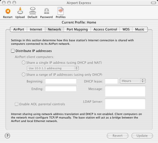

OK, I'm resurrecting this thread because the Airport Express arrived, is plugged into the wired router, and is working mostly fine so far. The only things I've changed from the default settings is to enable airtunes sharing over ethernet and brought the signal strength down to 50% as it's all I need. All computers seem to access the internet fine, however I had a little trouble file sharing between the wireless imac and the wired G3. I'm guessing that this has something to do with either the "disable NAT and DHCP" previoulsy mentioned which I don't see worded exactly that way in the airport config creens (I'm on Tiger). Or perhaps I need to change some other option. Any suggestions?

Make you windows look like this and it should work:

Cool, thanks. It looks like that did the trick. Could you provide an explanation for what that technically changes and why it works? Always looking to learn more.

EDIT: I also noticed (maybe in my head) that computers accessing the internet wirelessly seem snappier now. Is this possible, or am I imagining it? I seemed to have similar results when I first initiated my internet service last year. At that time, my modem and wired router were clashing as I think they had the same IP address, but once that was cleared up it worked like a dream. Is this a similar principle?

Well to understand what that did you need to know what NAT is and DHCP, I will start with the easy one:
DHCP (Dynamic Host Configuration Protocol) It is used the hand out information to the clients on a Network, in this case it hands out IP address.
NAT (Network Address Translation.)is what does the most of the work of a router. Since the world does not have enough IPs to give every person on the internet there own external IP NAT helps out with this problem. What it does is takes one IP on your external side(internet) then assigns internal IP via DHCP(normally in the 10.0, 192.168 range) then when a request for something is made it goes through the NAT router to the internet, when the site comes back it "remembers" who asked for it and sends it to that computer. NAT routers also block all traffic that it does not remember it being requested from a internal computer. This acts as a kinda "firewall" it however is not a true firewall.
You had two NAT systems one within the other. And yes you could see a speed increase when you disabled NAT on the airport as most NAT routers are not the fastest at figuring out where traffic goes. I noticed a speed difference when I upgraded our school to a m0n0wall vs a standard linksys
