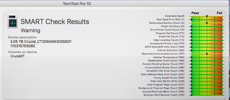

Your SSD could be having problems. Apple Disk Utility only gives overall Pass/Fail on SMART tests. There are many problems that can be occurring while still allowing DU to give it a passing grade. In the last couple of months, I've sent a Crucial MX300 and a Samsung 850 EVO back to their manufacturers under warranty — both passed SMART in DU but failed other tests. Here's the Crucial:
I use TechTool Pro to diagnose such problems. Notice that SMART shows as Passed. This drive was absolutely unusable.

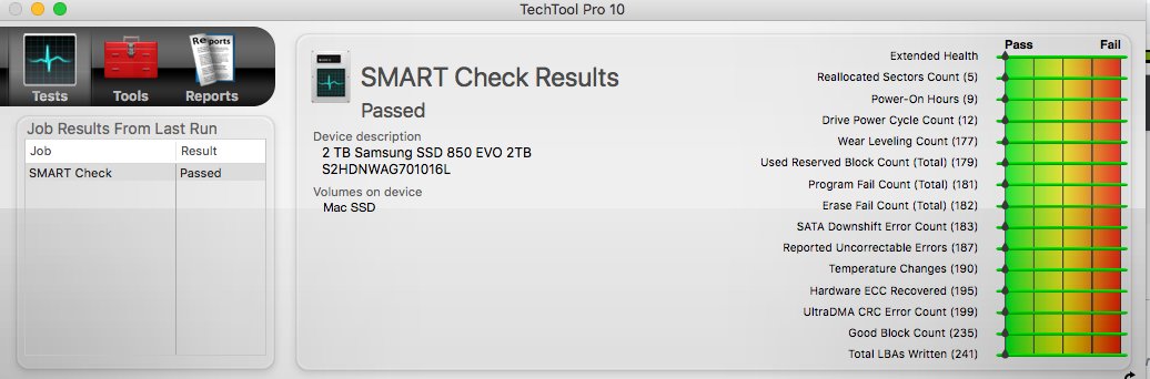

This is what they should look like:
