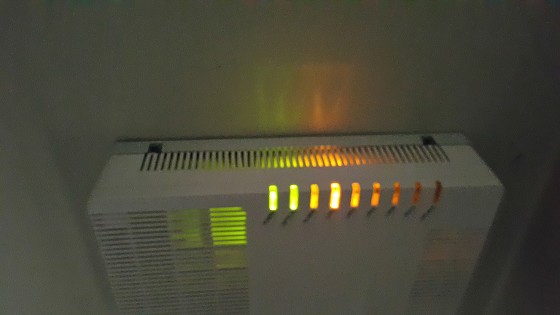

I'm from NYC. I see those lights on the SB6141/6183 and all I can think of is the neon "Motel" "Motel" "Motel" flashing signs on 6th. I could put my CM500 in a dark forest at night and you would still trip over it. 😉

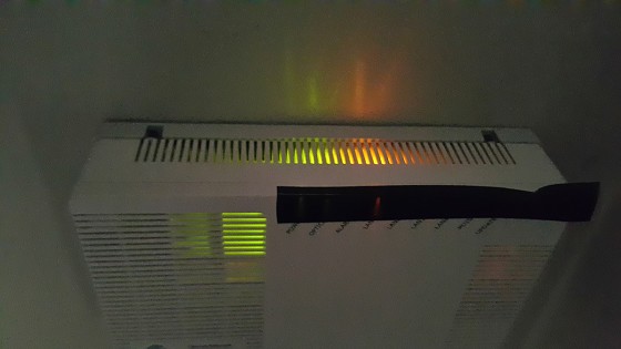

At least you haven't had to deal with an Alcatel. The tape does nothing!
