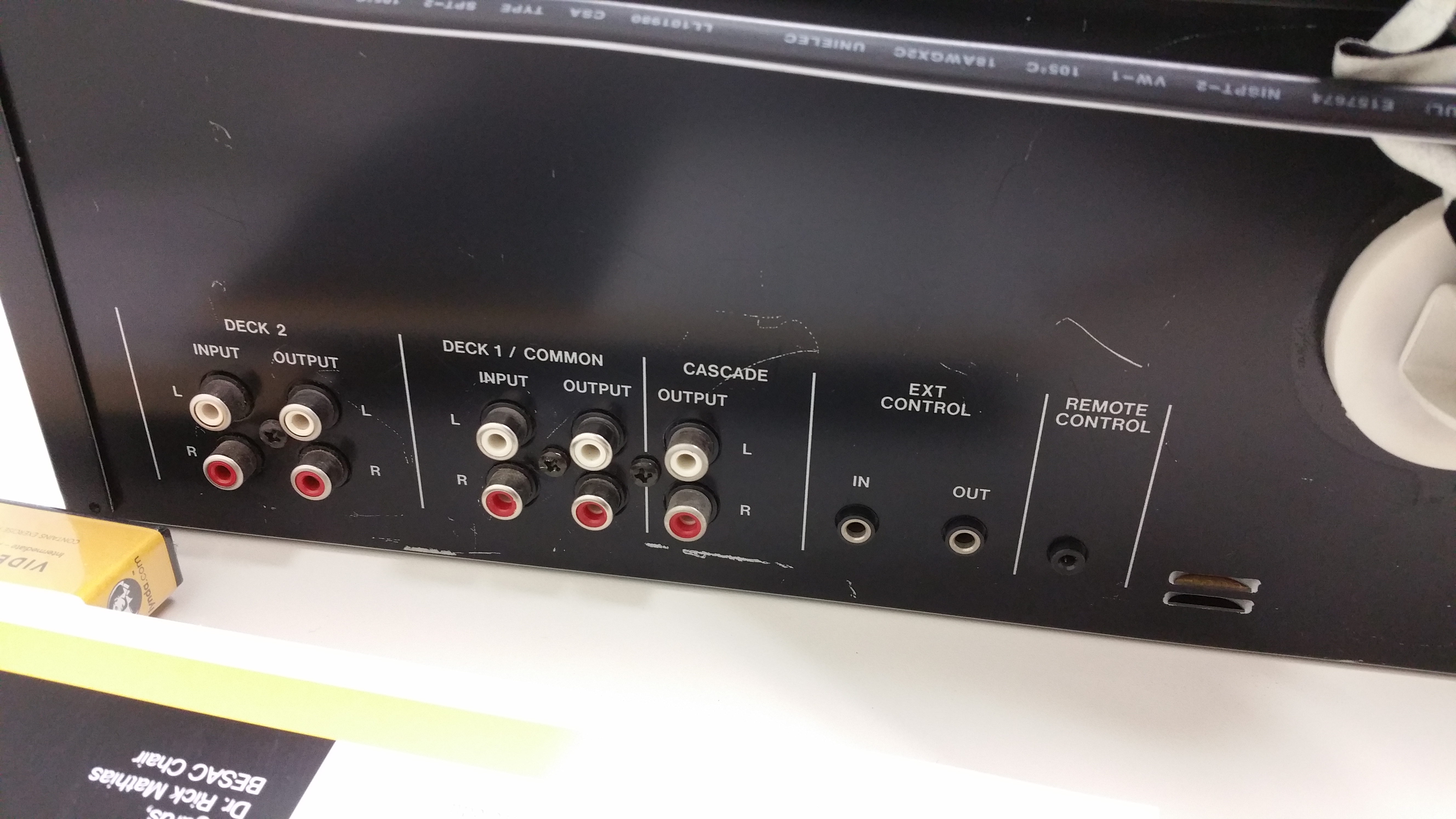

I have a 2013 iMac that I want to connect an old tape cassette deck (see attached image) so I can digitize some old tapes into Audacity or some other audio program. Do I need some type of device that will convert the analog signal into a digital one before it goes into the iMac? Can I just connect the RCA cables into the back of the tape deck that goes into the mic input on the iMac? Is there even a mic input on the iMac? I'm not at that computer right now...

Don't think you can use a straight cable connection, you'd need to convert the analog signal into a digital signal.

The current iMac doesn't have a microphone port, so at the very least you'll need a USB audio interface.
Example USB interface
You can then plug the tape deck in to the mic input and record it using Garageband, Audacity, or Audio Hijack.
Needless to say, the audio quality will be infinitely better from your existing proper deck through an adaptor, compared with what it would be on a $17 cassette player 🙂
The current iMac (2013, 2014, 2014 5K) does have a microphone input, it is part of the headphone/headset jack. It does not have a stereo line input like the 2012 and earlier models.
There is a microphone input on the 2013 iMac. However, the tape deck outputs line level signals so they're probably not compatible, and the microphone isn't stereo and your tape deck is... I'm not sure if what you want to record should have the stereo tracks preserved separately. So it's probably not your best bet. The aforementioned USB audio interface is a way around these issues because you probably don't want to use the microphone input, not that the iMac doesn't have one.

I've done a lot of these kinds of transfers. Be careful about "microphone inputs," because -- as dyt1983 says -- you don't want to be sending line level output from the cassette recorder into a microphone input. It will overload, and there will be nothing you can do about it.
Your best bet will be to find a USB interface that has line level stereo inputs. Then on the Mac end, Audacity receives the audio and will write out files for you.
Another option is to use a digital field recorder of some kind, provided it has line level inputs. Presumably you won't want to buy one, but maybe you know somebody who has one, or perhaps you could rent one (assuming this is a one-shot project). With a device like that, you just send your audio to the recorder, where it's converted and stored internally (ideally on a card you can remove). Nothing is connected to your Mac. Then later you transfer the digitized audio (which will be files like any other) to your Mac. Then you point Audacity at them.
The last time I had to do many cassette tapes, that's the path I chose -- but it was because I had a good recorder, and wanted to set up a recording/transfer station away from my Mac. I would just hit Record on the recorder, Play on the cassette deck, and come back later. That procedure suited me better than doing it on the Mac in real time.

That particular device and those that are similar will not help. Like the iMac itself, that device as a mono microphone input. What the OP needs is a device with a stereo input and one that can tolerate Aux level signals.
Aux signals are much higher voltages than Microphone levels and feeding the Aux out from a tape deck or stereo receiver into a Mic input will usually overload the input and cause clipping. At best, you would have to turn the volume way down on the tape to compensate for the increased amplification that the Mic input has which can increase noise.
The best type of device is ones link this one:
http://www.amazon.com/Behringer-UCA...UTF8&qid=1432918667&sr=8-3&keywords=behringer
Also, the audio cables can pickup noise from the computer's electronics. If this occurs you can often reduce or eliminate it by using a USB<>USB extension cable between the Analog<>Digital converter so that the audio cables stay some distance away from the computer. The digital USB signal is not susceptible to such interference.
