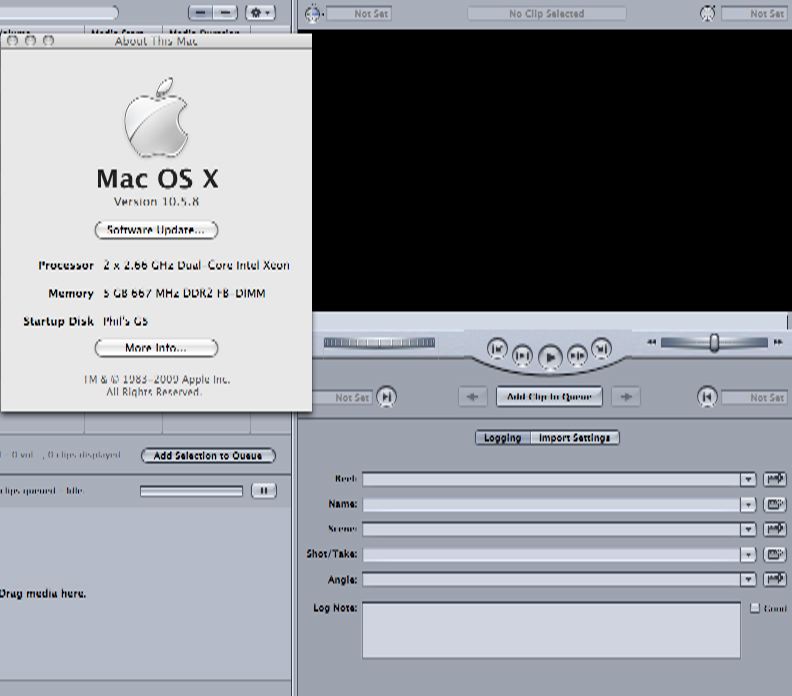

Do you have an Intel Mac or a G5 Mac?
What specific Mac do you have?
Look for the Model Identifier here (#3) and report back or look for yourself here..
What exact Mac OS X , Final Cut Express or Final Cut Pro and iMovie version are involved?

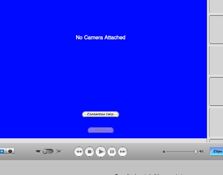

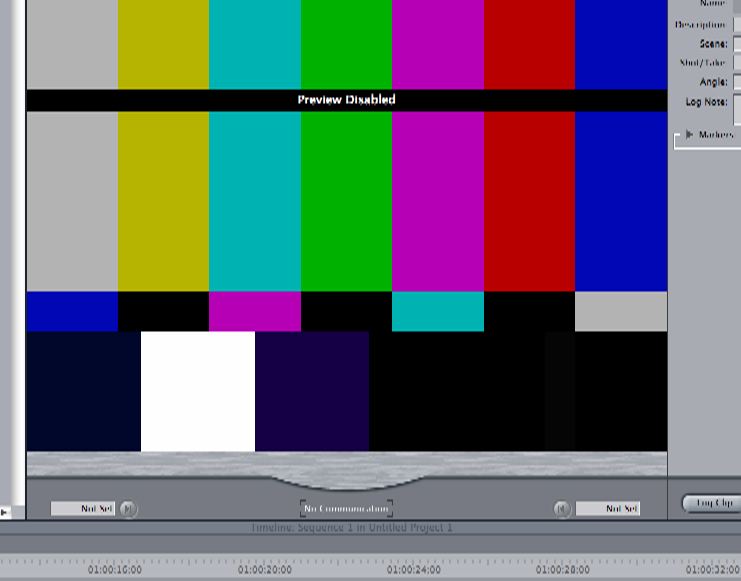

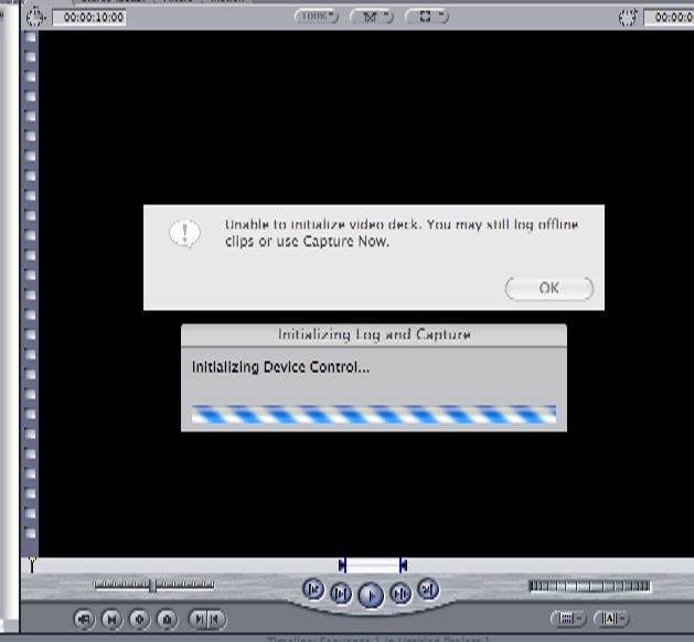

Canon HF200 capture problem
Hi spinnerlys,
Thanks for your reply. I have a Mac Pro G5 Intel-base. OSX 10.5.8
Final Cut Pro 6.
When I tried capturing on either FCP or iMovie, the capture window gave me the error message attached.
I was able to capture on Windows with Pixela that came with the HF200, and make clips for FCP, but they're not true 1080p.
Appreciate the help!

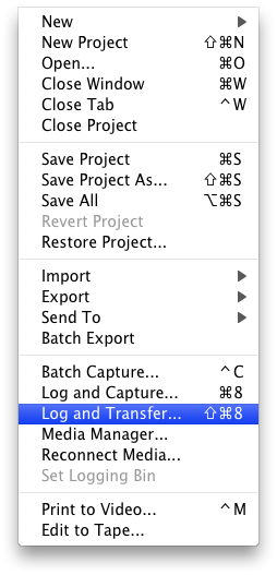

Okay, either you have a Mac Pro using an Intel CPU (x86 architecture) or a Power Mac using an IBM CPU (PPC architecture), there is no G5 Intel Mac, even though it gets mentioned a lot.
The other thing: The Vixia HF200 is a camera, which stores its footage onto a Flash Memory Card, thus "Log & Capture", meant for tape based media, is not the correct option.
You need the "Log & Transfer" window to import and properly transcode the footage into FCP. As FCP 6 came with a big manual, and a searchable PDF, it will you help to properly ingest video from your camera via the right settings.
And then there is MRoogle.

Good info. I tried Log & Transfer, but didn't find any options for importing AVCHD clips. The main problem here seems to be the camera being Windows-based. The clips aren't readable in the finder.
I'll see what I can find in the manual.

Problem Solved!
Went to Samy's Camera in Pasadena, and found out I needed iMovie '09 to get my Mac to see and transfer the files. Otherwise, I'd have to spring for the Leopard and FCP 7. Not ready for that.
