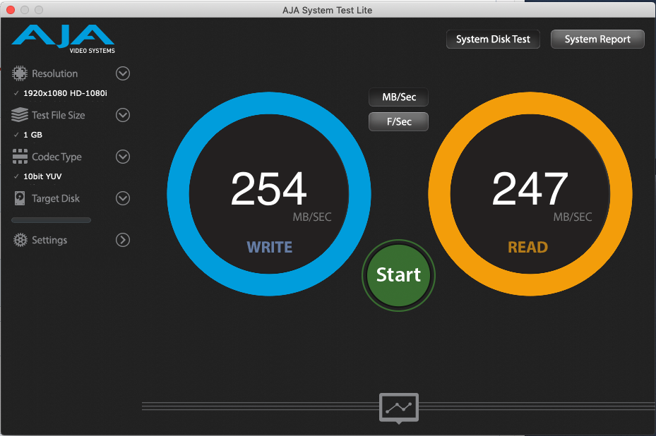

Samsung 860 EVO with older firmware had issues with Macs, and Crucial MX 300 are slow.
You're telling me 😕
Any SSD, even a "slow" one, will make that HDD look like it's standing still. Just buy any 2.5" SATA SSD that has the capacity you need. If you want suggestions, I'd go with Crucial MX500 or ADATA SU800 for a decent combination of price and reasonable speed. Yes, Samsung's are faster, and unless you are doing I/O intensive stuff I defy anyone to tell the difference without a stopwatch; they aren't worth the price premium any more, not for general computing.
Oh, and put everything on it except possibly inactive / archival data.
Those speeds are totally expected from almost ANY SSD connected to the cMP SATA II connectors.
Only RAIDing multiple drives or a PCIe based SSD will see better speeds.
With RAID, 3 drives in RAID 0 will generally max out the controller with speeds of 650MB/s. And that currently won’t be bootable. 10.13.6 and Mojave block booting from a disk utility created RAID partition.
For greater speeds buy an AHCI based M.2 SSD and pair with an Angelbird Wings PX1 or Lycom DT-120 card.
Failing the you’ll need to research on this forum how to inject NVMe support into your cMP firmware and then buy yourself a Samsung 970 M.2, but that solution is far from ideal IMO.
