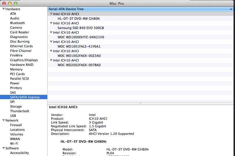

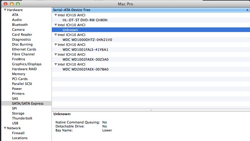

Plugged it in to the Lower Optical Bay directly and restarted. According to the System Info Screen Shot attached (together with the fact that nothing showed up on the desktop or in Disk Utility), I am guessing the drive is fried.

Likely the controller chip or connector broke/bad solder joint - I get the device ID show up normally just like with spinning disks doing data recovery if it's the flash itself. I have revived the odd controller chip with a heat gun before on both types of drive to get data off when out of warranty before but if you have a backup its RMA to Samsung time.
Yup - RMA time.

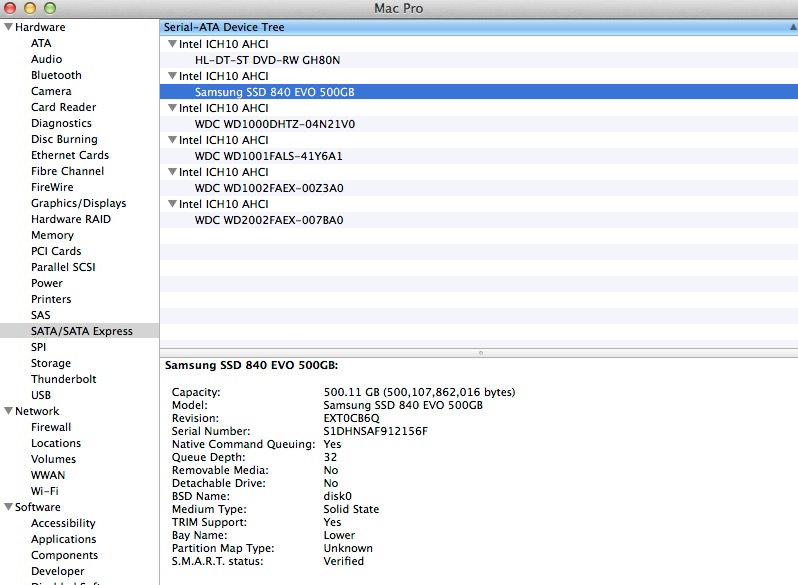

After verifying that the first SSD was dead, I pulled it out of the lower optical bay and plugged in the new 840 EVO that I received today, restarted and it showed right up everywhere...
