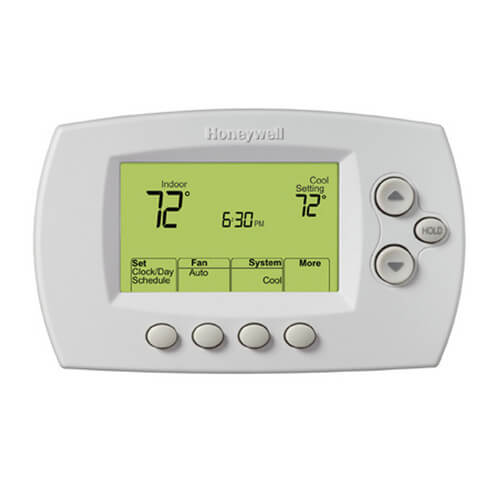

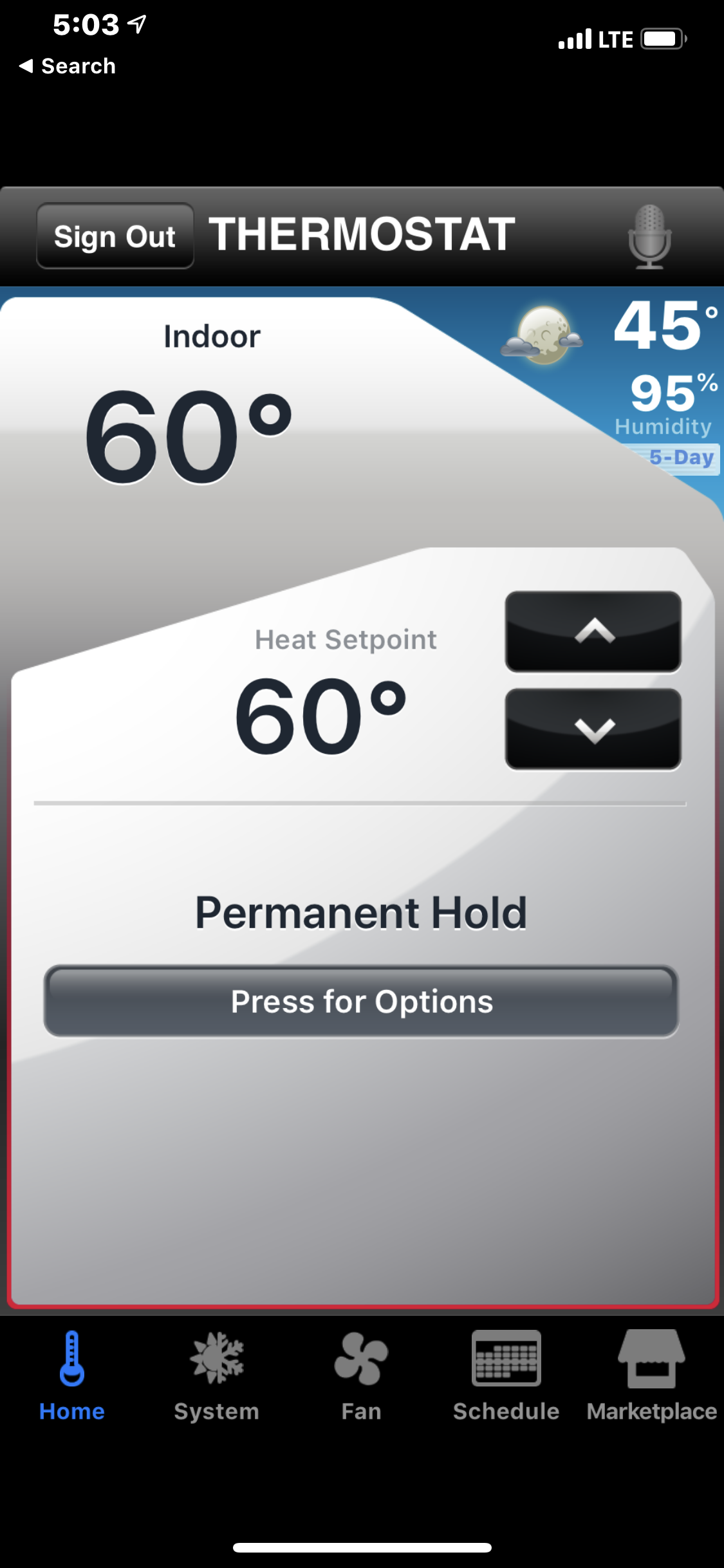

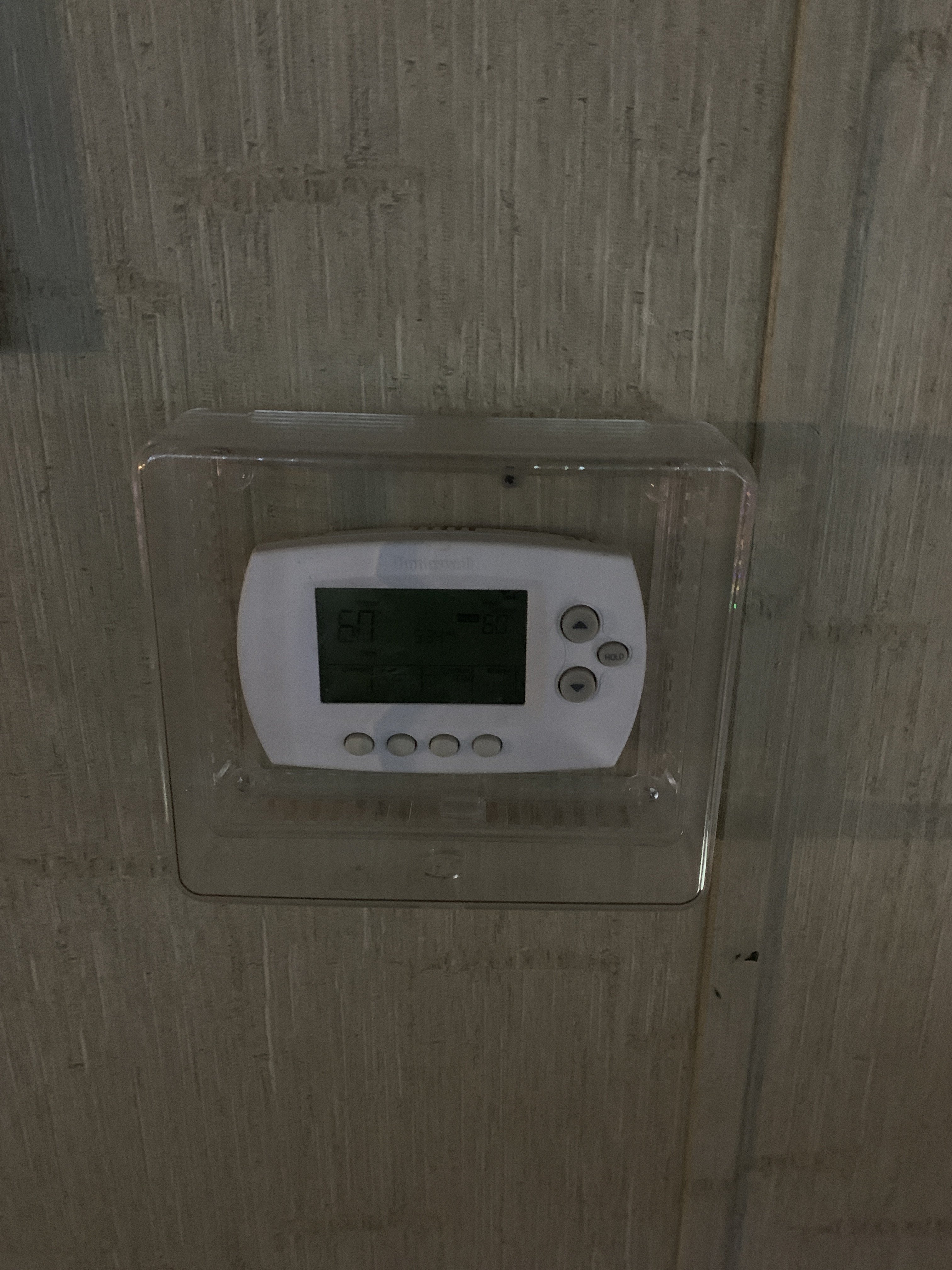

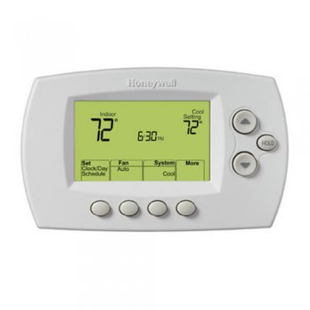

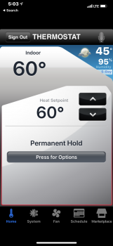

I have Nest and Ecobee 3 in my homes. However, if you are looking for an inexpensive option, look at Honeywell’s FocusPro. One of our facilities has 16 thermostats. At around a hundred bucks each, these are a great solution. Yes, they are controllable by Alexa or from the iOS app.
That looks like the one I have! How is it possible to control it via an iOS app when that Honeywell thermostat came out ~2007?
