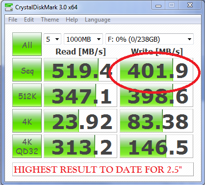

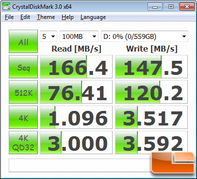

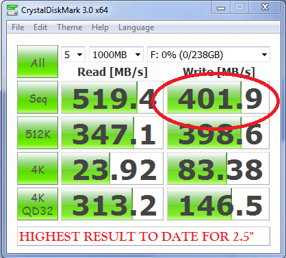

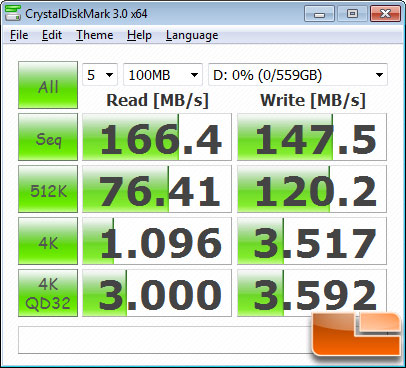

I only use the SSD for boot, Home account is on Velociraptor 600GB.
But you can't argue with these results. You absolutely feel the 4K boosts and they are immense.
WD Velociraptor 600GB vs. Samsung 830 256GB. The higher numbers are for the SSD.
It looks like CrystalDiskMark is Windows only, and I don't have it installed. 🙁
I agree 4k uncached random read/write will be faster on SSD, but one could simply create a RAMdisk and get results like this, which I ran 60 seconds ago:
