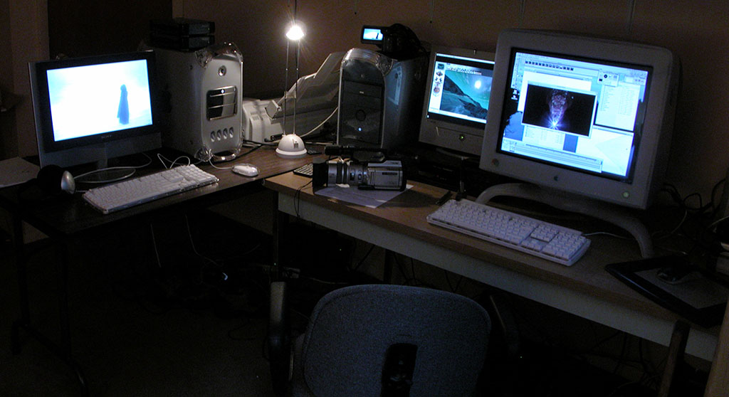

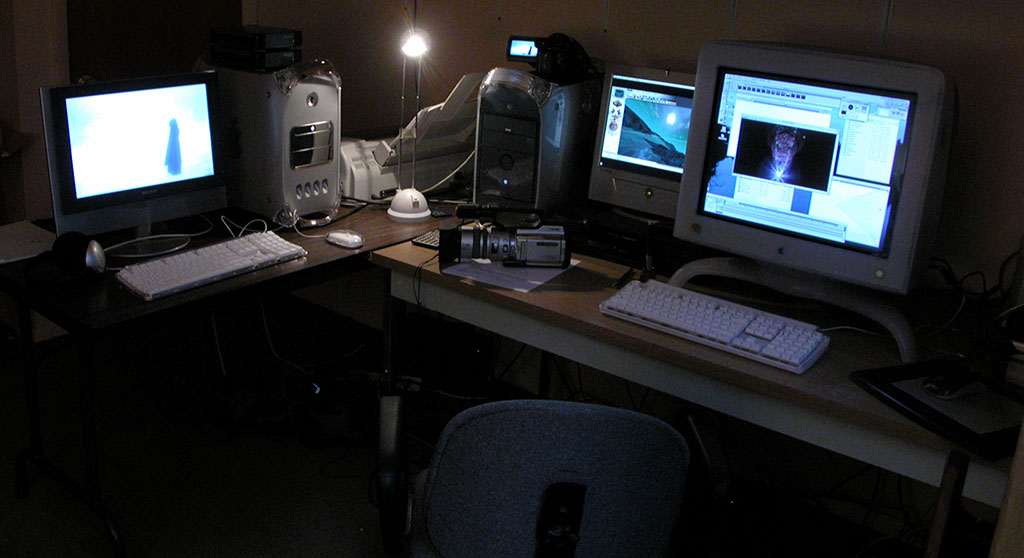

Was looking for a picture of my G5 but couldn't find one. This is more fun anyway, my studio in 2003 (a year or two before I got the G5). I hate to think how much I spent on all that technology! 😱 The grey G4 is the only thing that I still have today, but it doesn't work anymore.
And I bet your Mini is 20x faster than the combined power of all the hardware in the picture, at 100th of the footprint and power consumption 🙂

Only 20x? 😂 I also had a titanium PowerBook G4 at the time, that was one of my favorite computers but it was blown out when I connected it to a big theatrical DLP projector with bad grounding. Fortunately, my employer paid for that but there were no Titaniums to be had so I ended up going to CompUSA that night and buying an Aluminum G4 (which had just been introduced).
