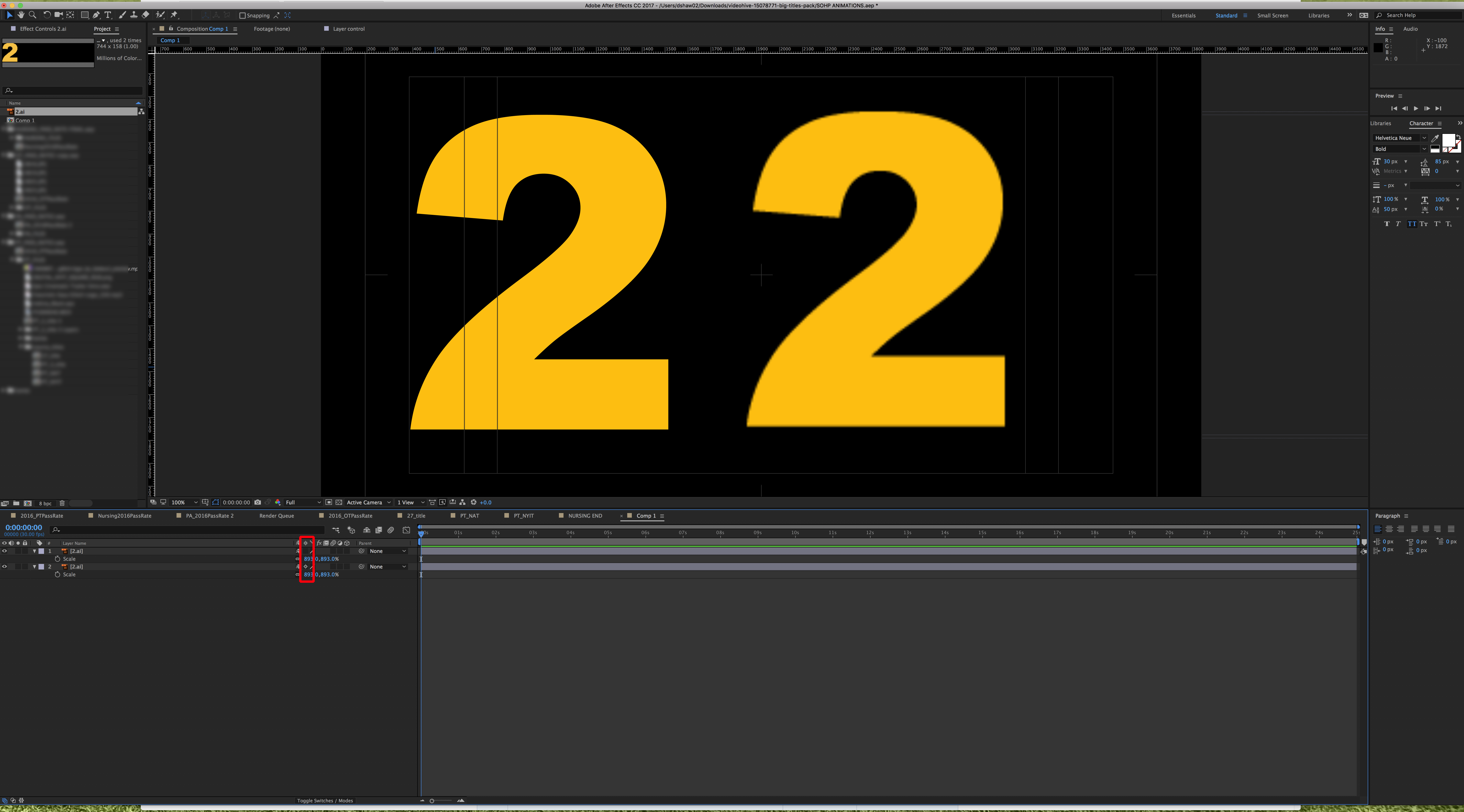

Illustrator files should be vector an scale as large as you need without any loss of quality. Hard to tell from just the screen grab, but there are a couple things that could be causing that.
When scaling the vector images make sure to check the continuously rasterize button (see attached).
If you dont see the switch, click the "Toggle Switches/Modes" button at the bottom of you comp window.
The other issue that I've run into, if you are not set to scale 100% and full quality, then send to Media Encoder to render (which I use a lot so I can keep working on other projects), Media Encoder will render at the selected quality settings.
I'd be willing to bet that's the issue, caused me a bunch of headaches till I finally found that switch 🙂
