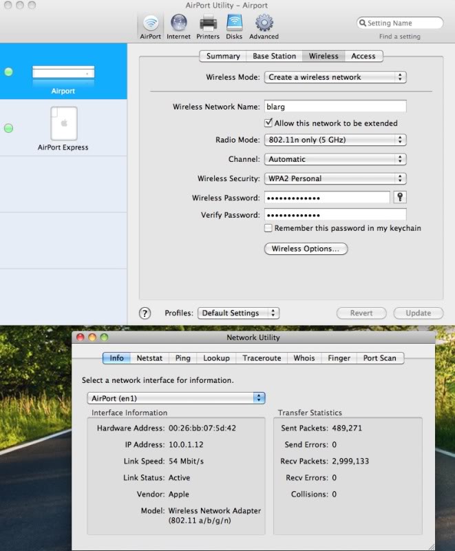

For some reason, my macbook pro chose to join the g network everytime. I put the AEBS @ 5ghz and then back to the mixed mode, and my connection stayed at 54Mbps.
So I'm just disconnecting my Express for now. Maybe I'll try to sell it or something.

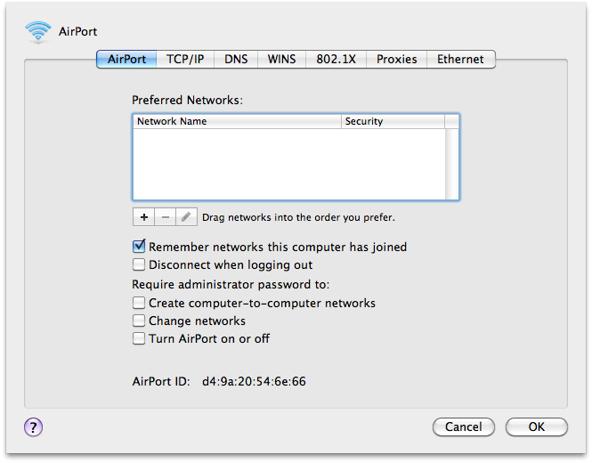

hmm i think it might be that the airport express network preference is higher then the ABES - you can check this by going into System Prefs->Network->Wireless->Advanced and looking at the preferred networks list. you will most likely have two identical network names listed there but trial and error might help to identify the "g" and "n" networks.
worth a try.
n.b. i dont use wireless 😉
