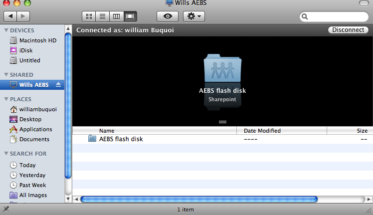

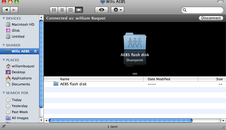

I'm trying to set up my AEBS to host my time machine drive but i can't figure out how to do it. I can't even see the drive connected. Can someone help me with this or link me to a thread already containing this info, I can't seem to find the right information.
Thanks in advance.
1. plug HDD into MAC.
2. Format HDD to OSX extended (applications/Utilities/Disk Utility)
3. Unplug HDD from MAC, then plug into AEBS.
4. Restart AEBS.
5. Open finder (AEBS disk should show up in the left column)
6. Click on AEBS disk, then click connect. (see screen shot)
7. Open TimeMachine
8. I think you got it from here.

I did all that right before posting then I found out that my new hdd had malfunctioned and was not even showing up when i plugged it directly into my comp. I took it back to the store thursday evening after work and had thenm exchange it. Took it home and tried again and it worked perfectly!!! Its always something😀 Thanks for the walk through anyways I'm sure it will be helpful to other members because it is exactly what you have to do to set things up right. I thought that I had been doing something wrong but it was the dang drive not me or my mac, YAY!!!
