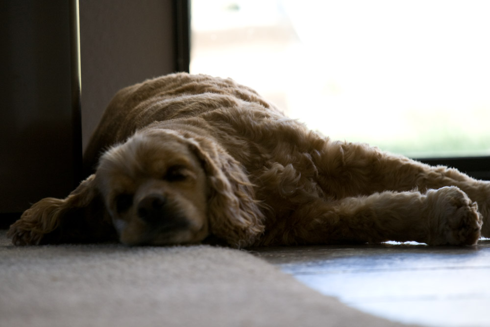

My 70-200 hunted badly to find a good focus taking the following shot (with no PP). This shot was taken 5 m away from the subject with focus eventually locked on his forehead. Unfortunately he jumped up as the shutter opened, so it's not that crisp. If the autofocus hadn't hunted, I would have gotten the shot I wanted.
1/160 at f/4.0
176 mm
ISO 400
no flash
lens settings:
1.2 m - infinity
AF on
stabilizer on
stabilizer mode 1

With the distance difference to give the AF sensors the same view you can't really do a straight comparison. However, you should look at IR AF assist, either built-in, as a part of a flash, on independently if you're having constant errors. The picture looks low enough contrast that you're likely to have problems.
The body does have a small IR AF assist beam built in, but it struggles at times. Adding a flash unit with more powerful assist helps a lot. With a 580 EXII attached I can get a 400D/XTi to autofocus more or less in the dark at 3-5m!

Looking at the submitted photo, I do not see that the AF system has a lot to work with as far as contrast.
Also something that might have helped would be turning the camera 45 degrees one way or the other, locking the exposure, recomposing and shooting.
I have had instances where the AF would not lock with the camera oriented in one direction, but did so after I changed it.
It's to the point where I instinctively do this on shots that I know will give the AF trouble.

Well for one, if your subject is 5m away, your limiter should have been at 2.5m-infinity.
OK, I'll try that, but I've had stuff hunt in the range of 1.2 - 3 m on the 1.2 setting. The interesting thing is that I don't remember any hunting when I first got the lens.
Anyhow, I'm not sure what you guys mean by low contrast. Although not apparent in the photo, since the subject is dark, there is a lot of color variation in the dog's hair. Additionally, there is a lot of luminance variation, from the strong backlight coming through his hair. Also, the dog appears dark because since everything outside was clipped, I had to reduce the exposure. In all actuality, there was quite a lot of light falling on the dog. So my question is, does the AF system use the absolute amount of light falling on the subject, or is it dependent somehow on the exposure settings?
There may be a lot of color variation but the transition form one color to the next is very gradual. If it locked up on the dogs forhead, it is because of the white spot.
Think of two pieces of paper, one black, one white, set the beside each other and there is high contrast.
Now imagine one piece of paper as wide as those two pieces of paper where the color goes from white to black gradually.
You AF will lock up easily on the Black/White paper, but not on the White to Black faded transition.
Some camera AF systems have problems with orientation. I recall that some cameras would 'hunt' on a test target with horizontal black stripes on white paper, turn the test target 90 degrees so that the lines are vertical and it locks up fast. AF systems have evolved, but are not perfect.
If I were shooting your dog, I would have focused manually using an aperture to give me the most depth of field and the shutter speed appropriate.
If I was to use AF, I would set the camera to use one focus point and place that point over the dogs eye, or some other area with higher contrast.
