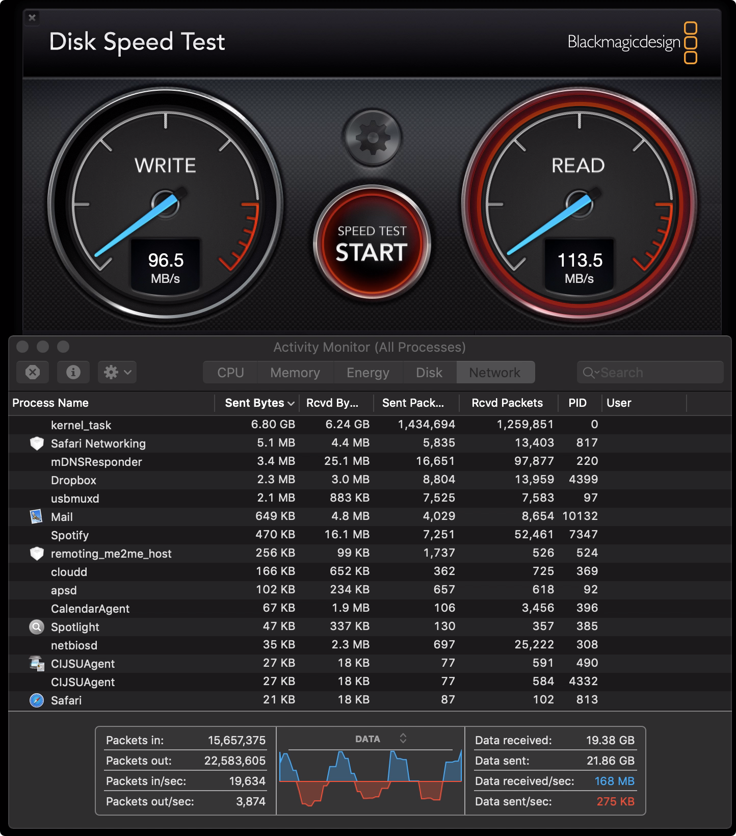

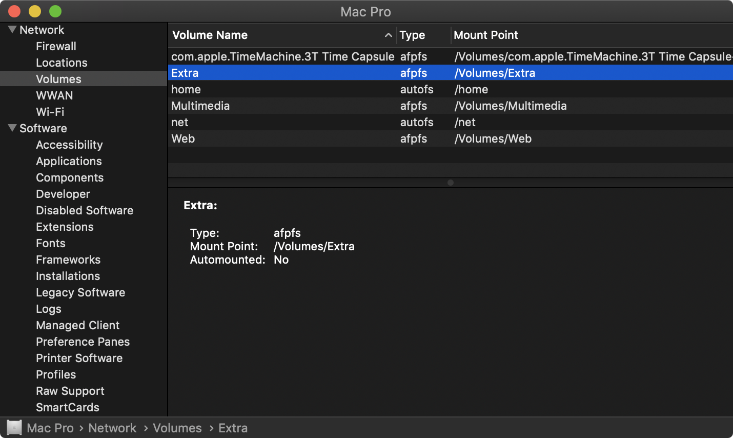

Just tested on my AFP connected volume.
Very normal speed via the 1Gbps ethernet port.
So, it seems not a Mac Pro specific issue.
Is that to an old PPC Mac running Leopard?
For me its fast with newer Intel Macs too..

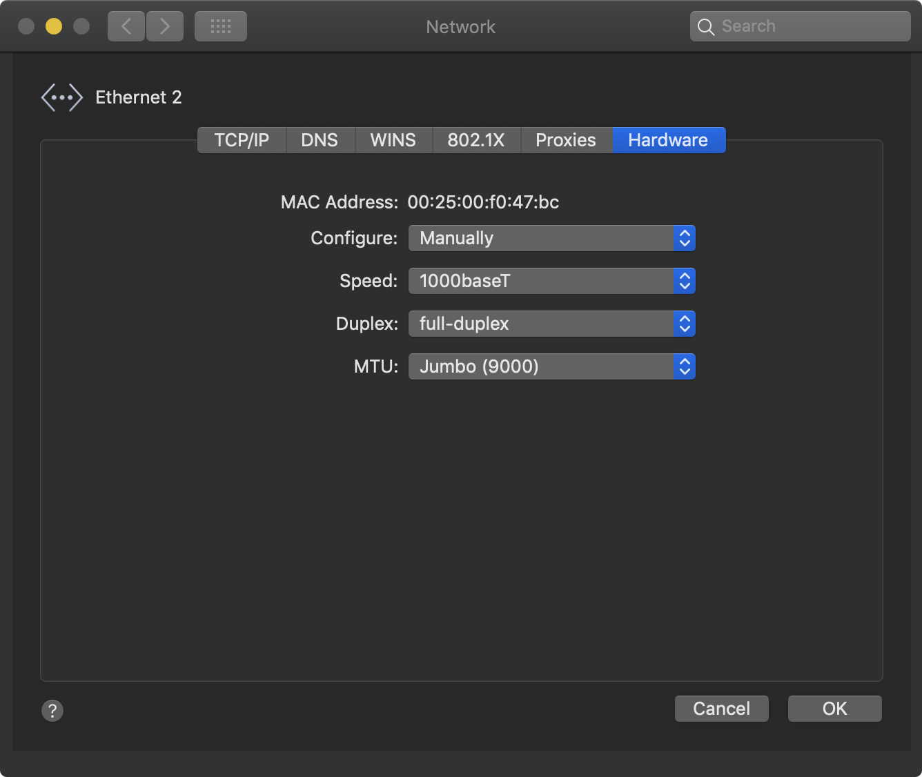

Anyway, for file transfer, make sure you enable Jumbo Frame in network. Even though I don't think this is your issue. But it can make file transfer faster.
I shall try MTU 9000 as well thank you !
Also are you on a private 192 network like i am? Can i see your 1st tab in Network prefs to see your configuration?
