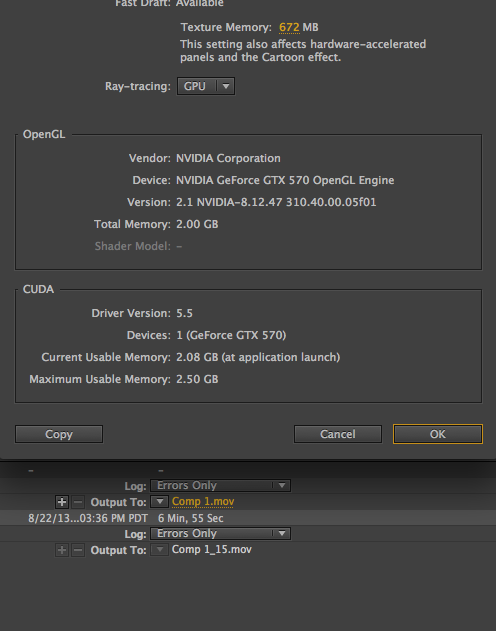

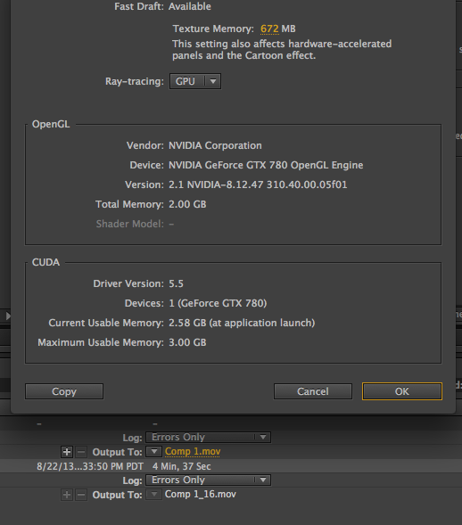

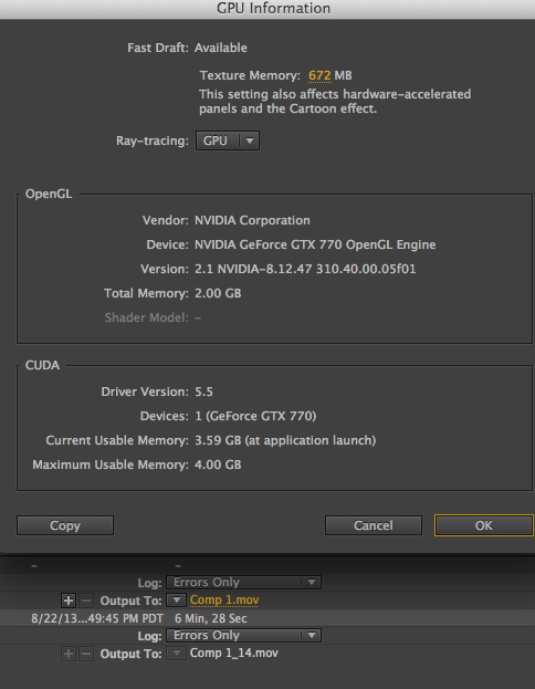

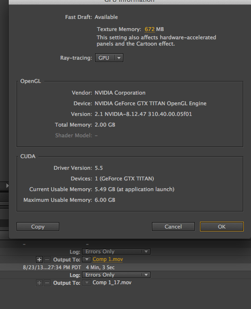

Finally got it running - Titan takes the lead !!!

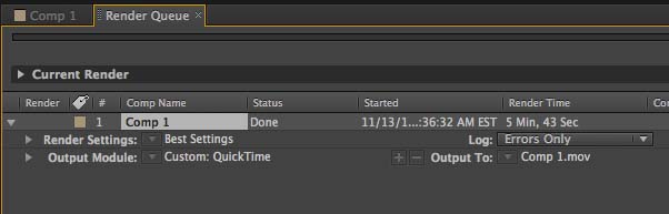

Ran a bunch of cards on the 3,1 with Dual Quad 3.2s.
My numbers line up with what many of you have seen.
GTX Titan 4:03
GTX780 4:37
GTX580 6:22
GTX770 4GB 6:28
GTX570 2.5 GB 6:55
GTX480 7:01
GTX680 7:02

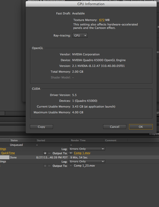

Quadro K5000 9:54
I'll update with a few more, including K5000.

By the way that Quadro K5000 got flogged!!!
Makes liam1978's result seem out of place??

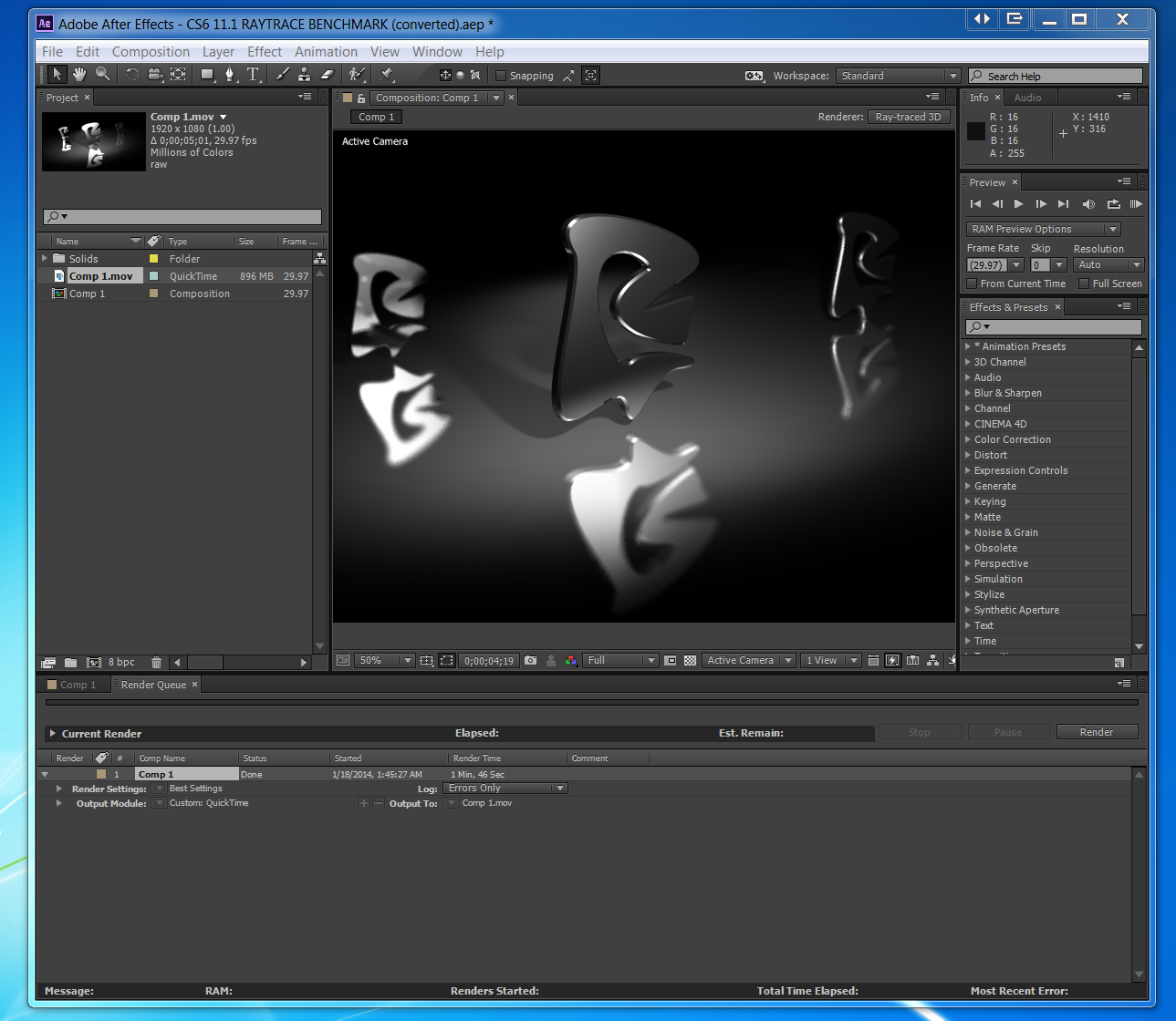

Hey guys - I need some help with this. Whenever I try the same benchmark that successfully worked before, the thing runs in about 55 seconds flat and produces a video with only one frame with anything other than black, that one near the end. I tried re-downloading the file, but whatever I try gives me the same no good result. Anyone else here solved this problem before?
Thanks!
Thanks!
Hey guys, I can see from some of the earlier posts on this thread that this same problem was solved by members here. Any ideas how I can get this benchmark to run correctly? I'm about to swap out my GTX 650 ti for a GTX 570 (in addition to the MVC-flashed GTX 580 already installed) and I want to see what difference it makes in hard-core CUDA processing.

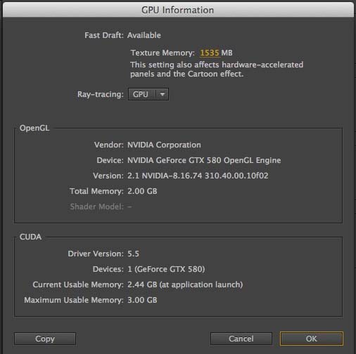

Fixed my problem with the benchmark. Not sure what happened, but I uninstalled AE, re-installed it fresh, applied the three updates to 11.03, and added my GTX 580 to the list of GPUs. Downloaded a fresh copy of the benchmark, and now it works again. In particular, works very well. Now I get a time of 5:43 using a MVC-flashed GTX 580.
To achieve this improvement, I did the following: re-booted my Mac (see specs below) and then systematically quit every single add-on I could find - all my servers, all the menu bar doo-dads, my anti-virus, everything. That's when I opened AE and adjusted the Texture Memory RAM available to the GPU to the max, 1535 MB (see below). Finally I opened my free memory app and repeatedly freed up memory until I had over 22GB free, and closed the app. I was ready.
The benchmark ran faster than I'd ever seen before, getting under 6 minutes for the first time. I'm stoked to see what it'll do in a couple of days, when I add a GTX 570 card to the system. Not as fast as Gymnut, but then again he's running a dual hex 3.33 machine with 32 GB, and I'm running a single hex 3.33 with (just!) 24GB. Either way, I'm satisfied.

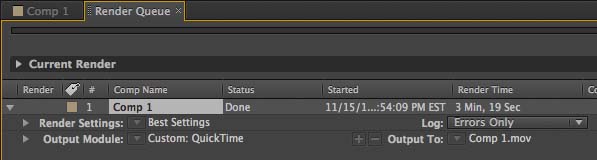

AWESOMENESS!! I just installed a 1.25GB stock GTX 570 to run alongside my MVC-flashed GTX 580. Within minutes of the install, I ran the AE CUDA benchmark. With both cards running at once, the benchmark ran in just 3 min 19 sec, using the NVidia driver under 10.8.5. Color me happy!!
