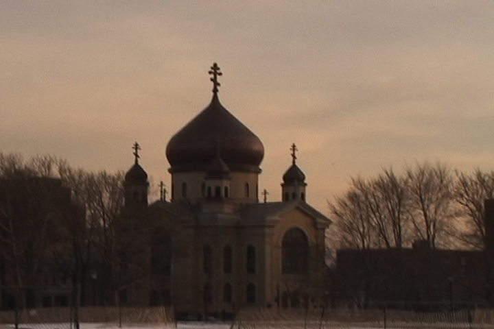

Ok I have footage of a Temple looking church in brooklyn that I shot handheld. Its about 300 yards away. Now I would like to add to this church maybe add a tower ontop of it with a digitmatte. My question is normally I would track this top of the church with a 1 point position track. I have done that and a 4 pt corner pin (perspective) to match a tv pan or something. With this becuase i zoom in at the end I figured to click on the scale option and use a 2 pt track. Could someone simply explain the best way to do a scale or rotation what these mean basically? I would apreciate it
--- I tried it and basically tracked the building top with 1 pt and the 2nd pt i tracked something close to the camera figured it would scale it and it worked sort of but the things i added to track had a serious jitter to them and didnt look smooth. Would i have to go in to the trackers and fix this cause im not sure how.Thanks again

I figured I took this still from the video. I want to simply add an extra piece like cg extension which I could do in photoshop becasue no parallax perspective change in the shot.

Ok so I made a tower in photoshop and wanted to add it to the top of that picture i posted. The picture is a frame from the footage. I motion tracked with 1 point the top of the tower. Well the right side of the curve and when i play it back it plays a bit jittery very small but extremely noticable. Could this be due to the fact the image seems to be all in one color tone?
