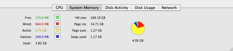

Actually, After Effects and Premiere do take some advantage of the GPU to speed things up considerably, but currently only with NVidia cards until CS6, and then only the latest AMD cards will be added.
Going above 4GB of RAM will definitely improve performance, in that it will allow you to multitask a little easier while working within the programs, and will also potentially give the programs more RAM to work with while you're editing. (You can check Activity Monitor to see how much RAM you are consuming while using those programs and see if you're paging out at that time. If you are, more RAM will speed things up).
8GB of RAM+ will also increase the amount of RAM allocated to the HD3000 from 384MB to 512MB, which might also help, but probably not at all in Premiere or After Effects since it isn't using the GPU for the Mercury Playback Engine.

I did a quick test. I edited some footage using Premiere and AE, and snapped this while exporting (rendering) the footage. Based on the information, would you recommend I go the 16GB route, or will 8GB suffice?
(2.5GB is currently allocated for Adobe application use under preferences in Premiere Pro and AE)
