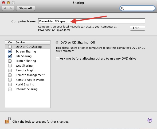

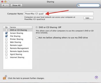

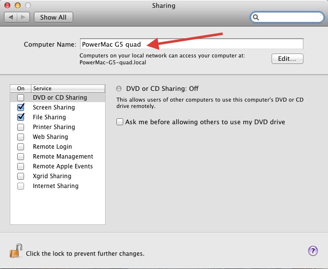

The G5 has assumed the name of my Ibook. That must be from when I did stuff in target disk mode from the Ibook (I wonder how that's possible though). Didn't figure yet how I might be able to change it back, or indeed whether it really matters (I do know how to change disk names, though).
To change your G5 name back...go to
System Preferences->Sharing, now edit the name shown.

Thanks, Jbarley, that worked!
