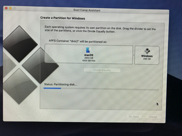

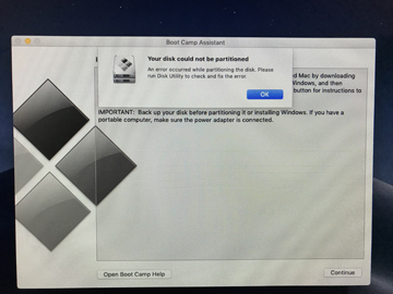

Alas, when I attempted to run Bootcamp Assistant after installing Mojave, I was met with a message that Your disk could not be partitioned An error occurred while partitioning the disk. Please run Disk Utility to check and fix the error.
So I did. On just the Macintosh HD volume, and then on the Fusion drive.

Great! I'd try to run Bootcamp Assistant again, and would again be directed to run First Aid to check and fix errors.
