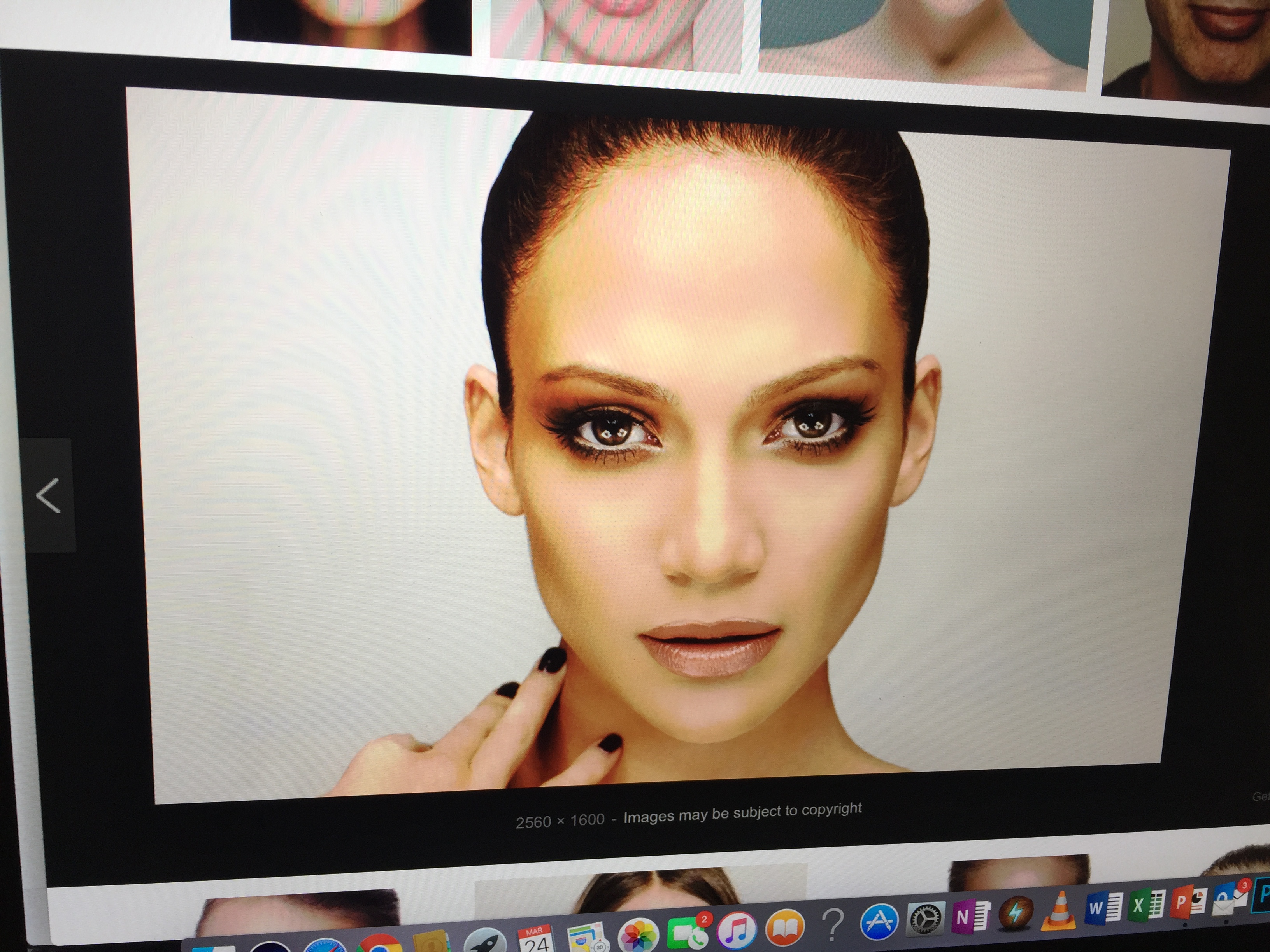

My screen was broken and I had it replaced, everything works perfectly the colors looks good but the photos and videos look ver weird (attached photo)
Did anyone experience such an issue before? Can anyone help?

Are you referring to the bighter spots on the forehead, nose, etc?
Take a look to see which color profile your display is using in system preferences -> display -> color. By default it should be using “color lcd”. This will be the recommended profile for your display, and unless you’re sending photos to a higher end printer (which will have its own specific profile) the one you should probably be using.

Many thanks csurfr yes thats right I refer to strange effect and spots around nose and forehead, I did so and also tried color calibration but still didn't work

It's possible that something could be off on the screen itself, but I'd still lean towards some sort of calibration issue. The photo looks fairly flawless on my 2017 15"
thanks for sending the screenshot, I think its a calibration issue too but I can't fix it myself I hope someone can help

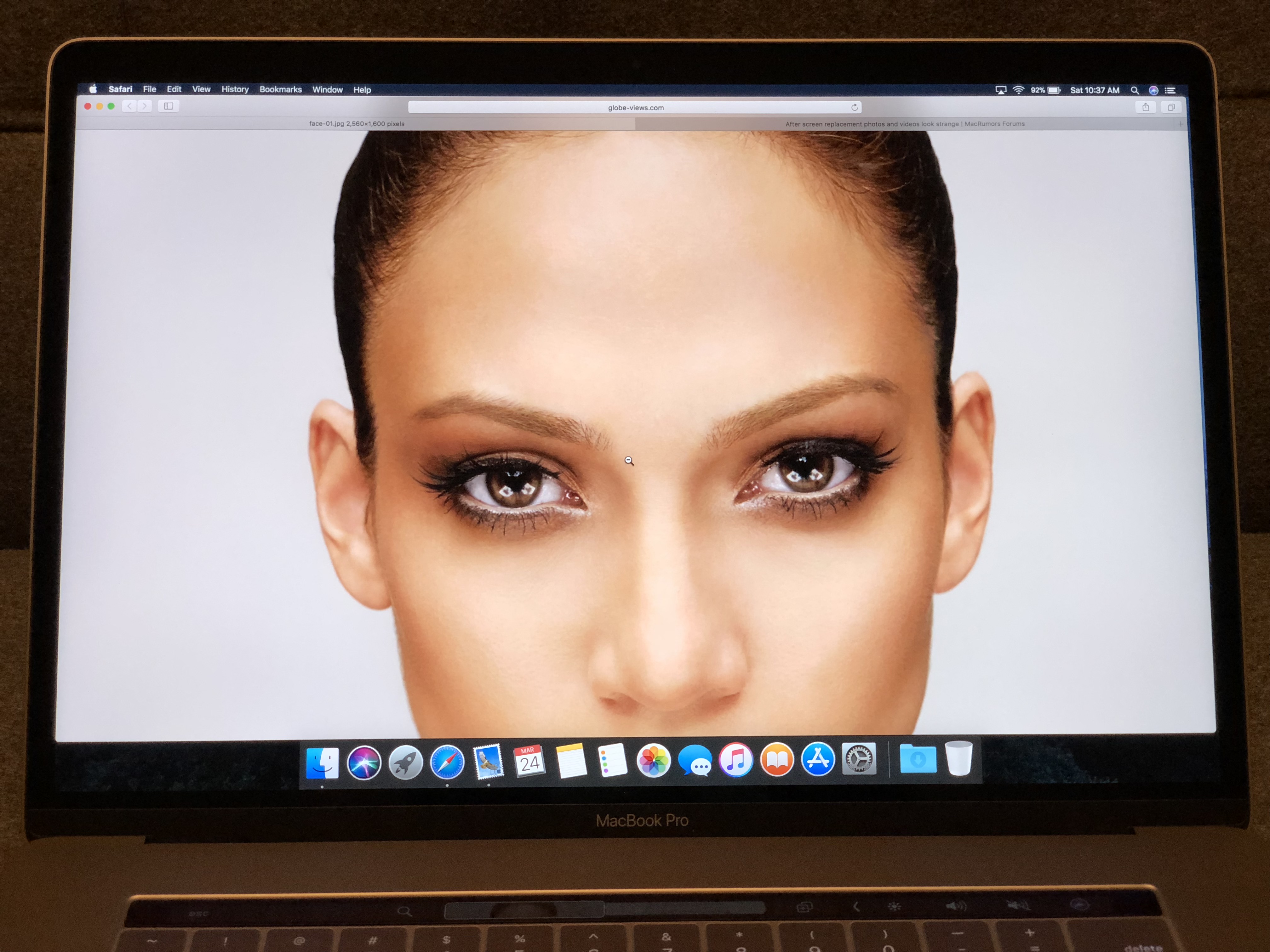

Try an external display and see if it looks better than your screen, if not check back with the repair shop and show them the issue because the LCD they installed can be none OEM/defective
Islam-
Thank you all for your help, I went back to the repair shop yesterday and they changed the screen one more time as it seems he used an earlier version screen that wasn't compatible with the laptop (mine is a late 2015, he used an early 2015 model I believe) he changed it and it works perfectly now
