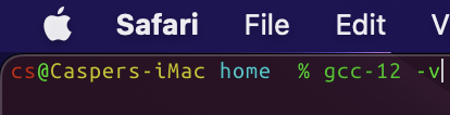

Yes. The path for homebrew installed packages is lower priority than the default Apple PATH. To get the homebred-installed gcc, you need to write the specific version. As such
If you write "gcc-" and then hit the tab key (possibly twice) it will show you options or auto-fill the last bit
Awesome, I get the same reply now as you stated above when entering gcc-12 -v
