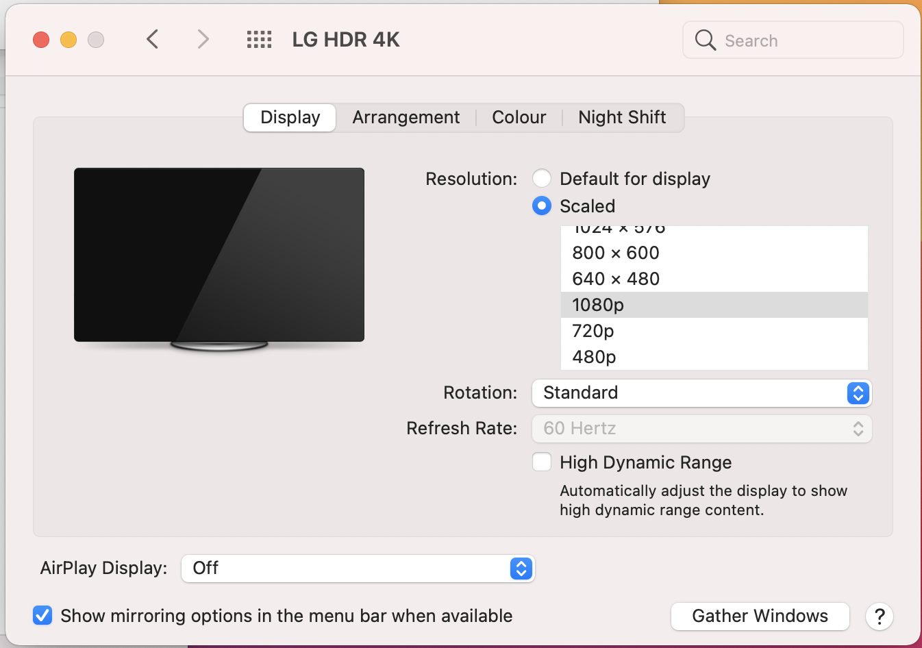

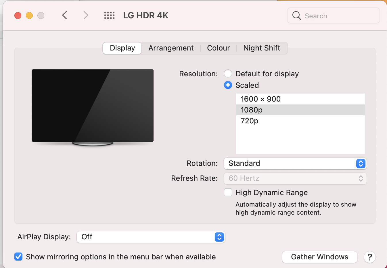

I have a LG 43 UN 700B 4K HDR Monitor. But after the latest update to big sur 11.1 its no longer possible to use 4K Resolution... even with SwitchResX the resolution is unavailable....
I restarted and plug / unplug the monitor already several times but it will not work...
Somebody else had a similiar problem?

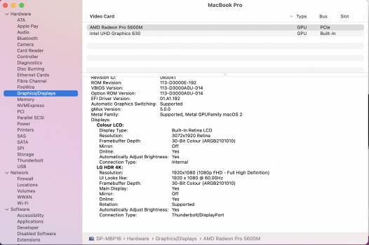

Have a MBP 16 with 5600m and TB cable.
Tried different TB cable, usb-c to Display Port (which was not working), i checked with my Dell Workstation that monitor is still ok (which is the case), repair installation....
Do you have as well a 5600m? Maybe its a driver issue?

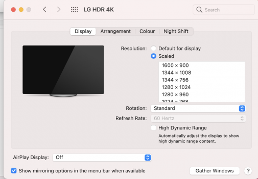

After a lot of tries at least i have the display running at 3360x1890 with 30hz (makes no sense at all).
The worst thing is that there is no way to make a downgrade... its my main working computer and i cannot work 8h a day without external monitor... 😳

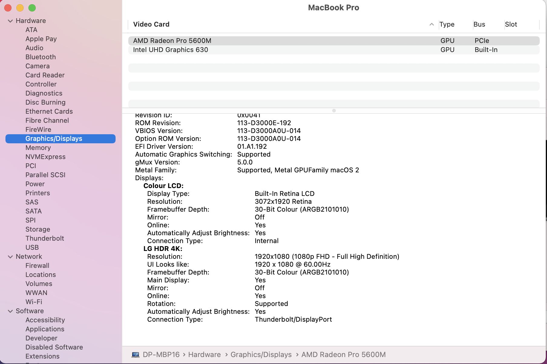

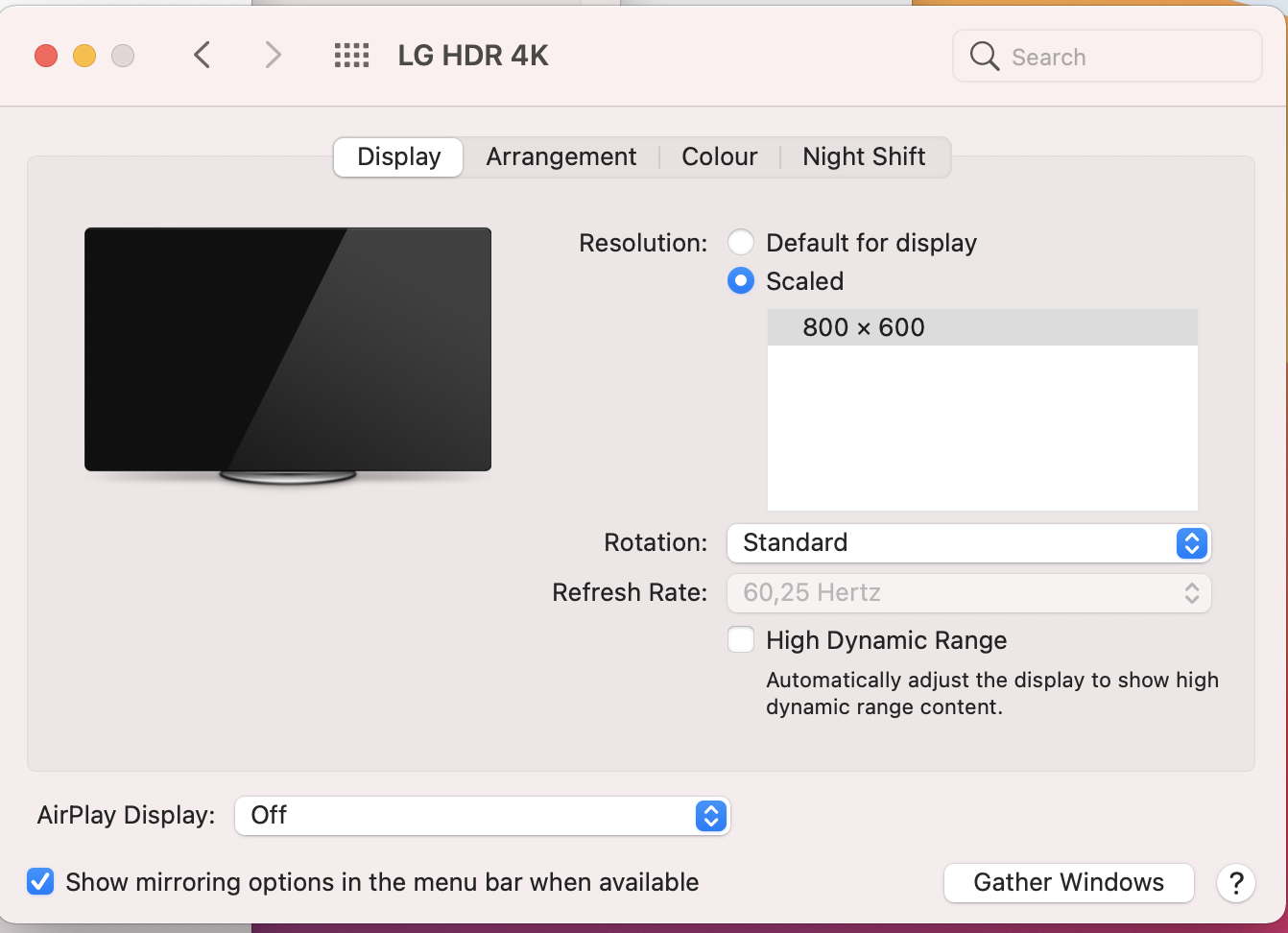

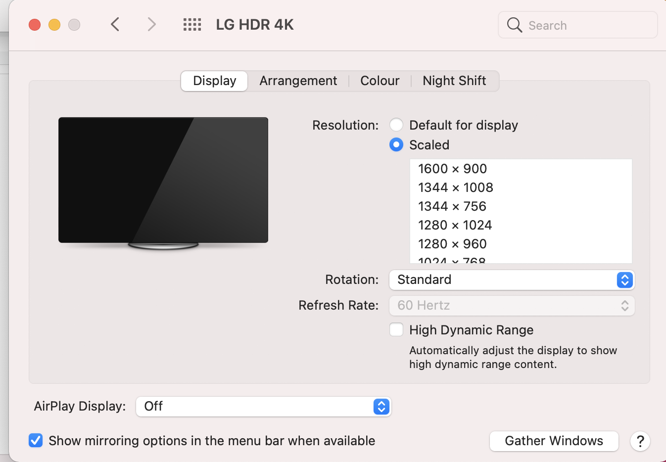

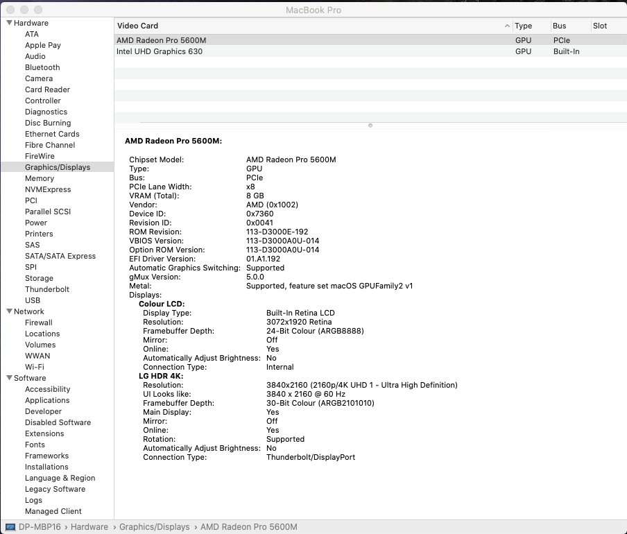

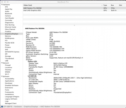

With 11.0.1 there was no issue it just started after the update. As you can see at the screenshots everytime i un/plug the display it show different supported resolutions...
