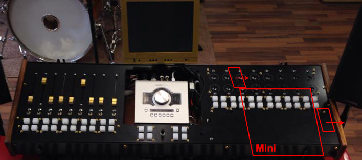

Hey people,
I just signed up on this forum, because I have a question regarding the heating issues of a mac mini. Mine is a i7 2,6GHz with 16GB RAM and SSD. As far as I know, high temps are "normal" on this model.
In Idle I have 50° celsius with fan speed at 3500rpm (set with SMC). When using software (Mainstage in my case), it goes up to 90-95° and the fan starts to spin faster till it reached 5500rpm. It stays there till I quit Mainstage.
For some reasons the mac mini sits in an enclosure with limited space and so limited air. I putted two 50x50 fans inside this enclosure. One "shoots" to the air slot on the back and the second one is screwed to a hole in the enclosure and blows the air out.
I turned the mini upside down and putted it on four little feet.
I need to get this thing cooler. Because when the summer comes it could be, that this enclosure is placed on a warm spot and I'm afraid, that will kill the mini.
My idea now is to saw a hole in the bottom of the enclosure and put a 120mm fan into it. But I'm wondering in which direction? Do you think, it's better to give the mini some fresh air by blowing air inside the box or does it lead to heat accumulation? Or maybe I should place the fan like it draws the hot air out of the case into the nature?
Attached there is a picture of the case. BTW: The bottom is made from 9mm wood. So it would be pretty easy to add a hole, that is big enough.
Thank you very much!
Best regards from Germany,
Chris

This is normal. The processors are rated to 105C and if they break that threshold they will shut down to protect themselves. Unless your mini is shutting down I see no reason to worry. This has been discussed time and time again. There is no widespread heat issues and only those storing their minis in poorly ventilated areas have any issues. There have been several threads on modifications if you really feel it necessary. With that said my mini has transcoded videos in handbrake for days straight running well into the 90s with no issues.
From what I read here it appears your modifications are counter productive and fighting the designed natural airflow.
The mini is designed to draw cool air into the bottom and exhaust it out the rear slots.
Blowing a fan into the rear slots would impede the exhaust of warm air, and mounting the mini upside down restricts the natural upwards flow of warm air rising.
The best solution for enclosing your mac would be to duct the output port of the mini directly to the outside of the enclosure. It may be useful to use fans to push air into the enclosure, and pull air out of the exhaust port.
The best solution for enclosing your mac would be to duct output port of the mini directly to the outside of the enclosure. It may be useful to use fans to push air into the enclosure, and pull air out of the exhaust port.

Thanks for your replies!
I've ended up with opening the mac mini and replacing the old thermal paste with new one. When I reinstalled the mac, I made a hole into the wood and placed a 120mm fan into it. This one blows out of the case (sucks the air from mini, which was a mistake...). I had a wrong information about the fan, which runs inside the mac. I thought it draws the air into the mini. I did remove the bottom cover too.
The result: I have a temperature drop of 10-15° without using the installed 120mm fan. When I switch on the fan, the temps are rising and the build in fan of the mac slows down a bit. I assume, that this is caused by the airflow from the mac out of the enclosure. The next step would be, to turn the 120mm fan so it blows inside the case. But for now I'm pretty happy with temperatures. I'm far below 80°.
