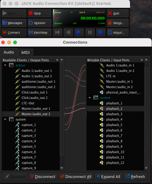

You can direct the sound of anything if you really want to. Depends only on the willingness of programmers to support QjackCtl in their audio software. I am not currently able to test what it does with two or more audio interfaces. I think it should work very nicely.
Thanks, olavsu1, I've never heard of this before. I'll definitely check it out!
