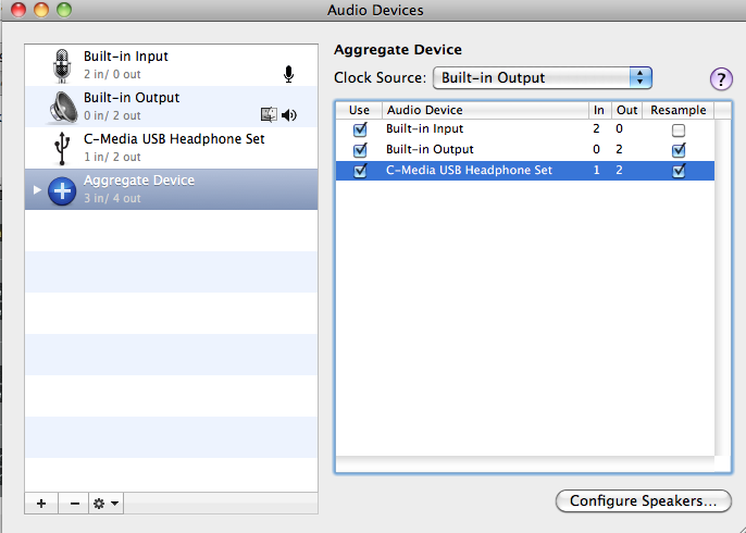

My problem is when I aggregate the soundcards (mac's own and this other one) together inorder for Traktor to recognaise them ( I end up with a 3in 4 out combo), a problem develops....unlike in other software (mixxx and VDJ) where you can just state that you have to sound cards and then assign to outputs to monitor and 2 to speakers; traktor gets confused and plays the mix through both speakers and headphones, and when I press the button on the controller for the deck i want to hear through the headphones I hear the entire mix plus the mix I want slightly louder. This is kind of defeating the the purpose of the headphones
I think the problem lies in the Audio MIDI set up utility with clock selection and resample boxes needing ticked or something....but I am far too much of a noob at that.

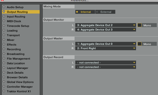

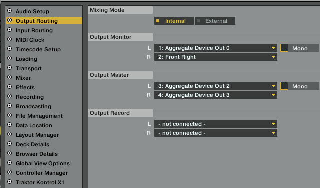

Thanks for your reply, glad I could help you, but I just tried your method and it didnt work for me, I put the speakers through usb sound card and headphones through built in but this time the speakers got louder when i seleceted which deck to listen to with "headphones"
Some screenshots of my set up...you appear to have one more input than me on ur usb soundcard :S Which card do you have? Any ideas on my problemo?
Dont know why it is calling my USB soundcard headphone :/ thought he headphones do need a usb to power them

Slight progress...When I set up like this
Screen shot 2011-03-07 at 22.04.20.pngScreen shot 2011-03-07 at 21.58.12.png
Then I can monitor headphones when both channels are muted on mixer otherwise i hear everything plus the one i want to much louder....actualy thats back to square one 🙁
