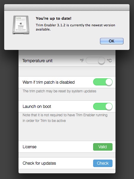

Additiional question; are you planning to use a thrid party trim driver like Trim Enabler or Chameleon? I'm reading some say do and some say DON'T! Any thoughts?
Cheers
Your latest idea on using RAID 0 for OS X and SATA 2 for Windows should work fine.
I have always enabled TRIM through terminal. The only down side to using terminal is that it must be reenabled after each point release of OS X, but I assume the same should be true of other enablers.
But, reading several forums it seems to be the OMDQ, should one enable trim or not? Some say it will degrade the SSD faster then without...? I find this very confusing, it's my very first SSD ever. Perhaps I should send Samsung an email!?

Have to enable trim for SSD's.
Every time you write to an SSD, you are shortening its lifespan. But, at least on my SSD, TRIM allows the drive to function better and is recommended. I can't speak for the Samsungs, I've never looked in to getting one and don't know if they do anything differently.
I've read about the OWC SSD using the Sandforce controller and therefore it is recommended bij OWC to unable TRIM!
Best for me to send Samsung an e-mail! Stay tuned!
Cheers

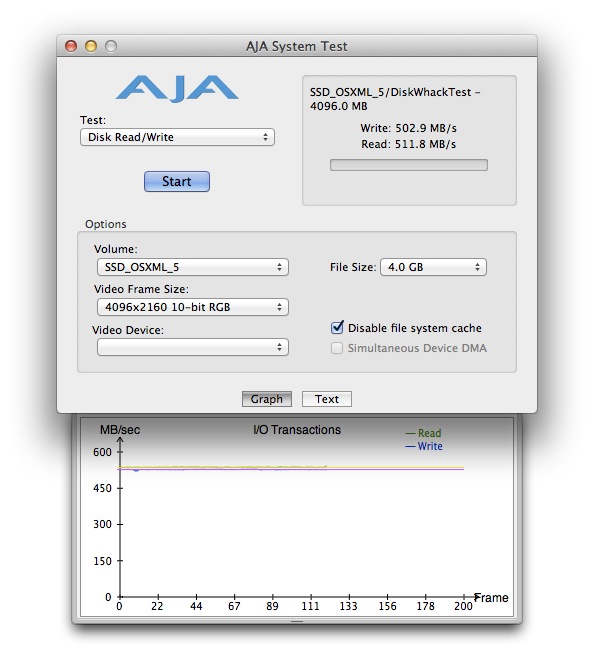

UPDATE: Installed TrimEnabler Pro 3.1.2 + first benchmark (after booting from recovery disk and did a repair disk permissions, then rebooted again)
Appricorn VELO-X2 (slot#2 x16) + 1x Samsung SSD 840 EVO
So far so good! 😎
