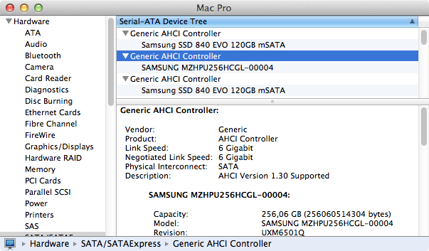

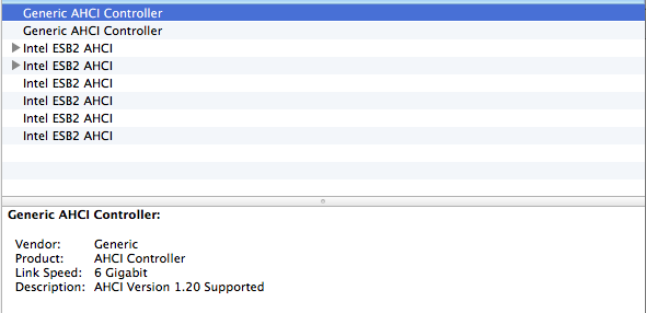

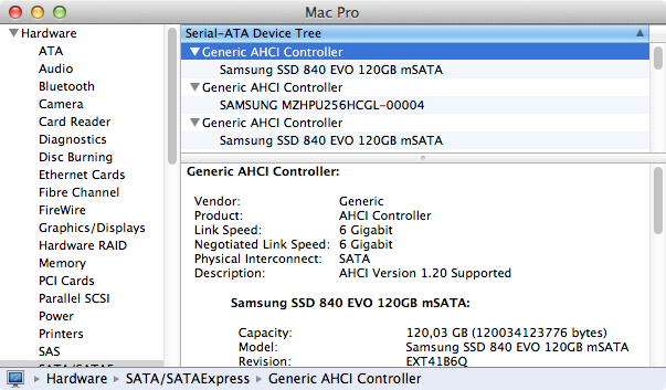

It's supported on cMP but not on ICH. Only with newer controllers.
Marvell 88SE92xx (Sonnet, Highpoint, Addonics SATA 6Gb/s PCIe adapters) seem to support 1.20 only as well.
See screenshots: first is Samsung NGFF on Lycom DT-120, second is mSATA on Lycom PE-125.

After a some more research, it seems the answer isn't that straightforward as it appears... Need to study drivers dependencies a bit.
If you want to use port multiplier feature, you can try Sonnett driver. I can't say if it's restricted to their cards only, but maybe it's worth a try: http://www.sonnettech.com/support/downloads/software/dskcd-ahci_pm-11.dmg
Back your original AppleAHCIPort.kext before installing, or install it on a spare drive just in case.
Just to add a bit more information, the Velocity Solo X2 only supports 1.19 with Yosemite PB3. I'll check and see what Mavericks uses in a little while.
