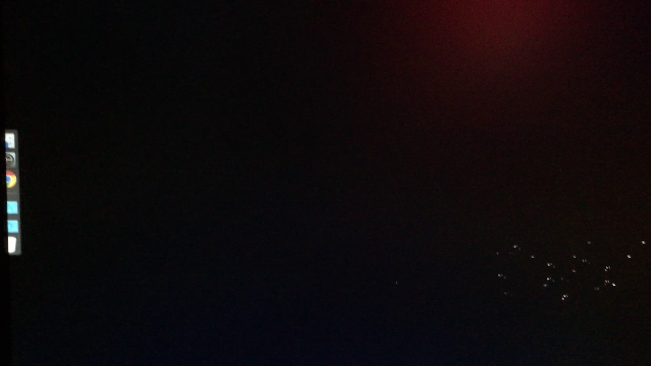

Hello. Recently (received last week) purchased a 2010 MacPro 5,1 online. There are two GPUs installed, a AMD Radeon 5770 (slot 1) and AMD Radeon RX 580 Pulse (slot 3, i believe, not sure its taking up 2 slots so it maybe slot 2, but its right above the 5770). Both GPUs appear to be new.
I've taken the Sapphire out and tested just the 5770 with AHT and all of the board slots do not throw any error messages. It states "No trouble found".
When I add the Sapphire back into the mix in either of the slots, AHT throws the error '4SNS/1/C0000008: Te2S--124', which I've read here: https://www.cnet.com/news/how-to-invoke-and-interpret-the-apple-hardware-tests/ is a bus temp sensor.
My question is this, is the error being given due to the card not being natively supported for the test or does it sound like something is wrong with the card?
The last thing is that theres a weird graphical glitch (see attached image) which happens during shutdown, every time so its reproducible, but otherwise the card seems solid. The glitch looks like a bunch of rows of shimmery white specs. I've run LuxMark, Geekbench, etrecheck, and theres no GPU errors. I have not installed FCPX and started actually using the card yet, because I wanted to thoroughly test out the machine before setting everything up/installing all the software.
Thanks in advance for any input.

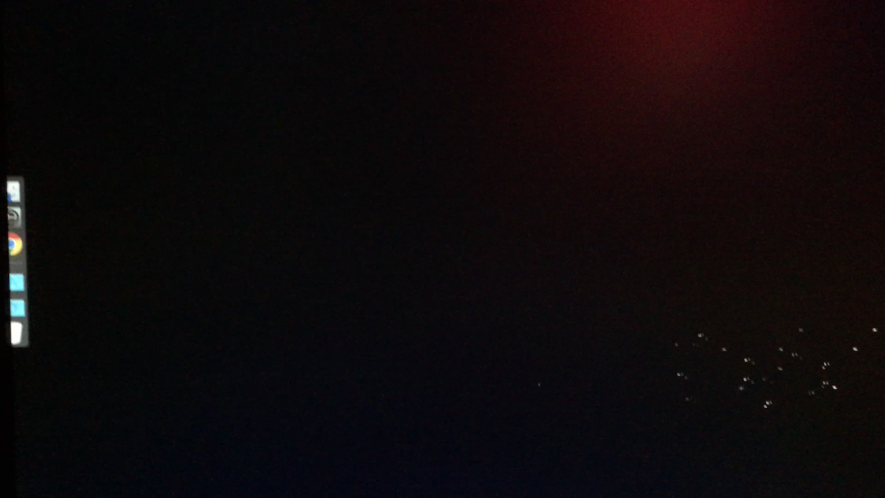

View attachment 779867 Hello. Recently (received last week) purchased a 2010 MacPro 5,1 online. There are two GPUs installed, a AMD Radeon 5770 (slot 1) and AMD Radeon RX 580 Pulse (slot 3, i believe, not sure its taking up 2 slots so it maybe slot 2, but its right above the 5770). Both GPUs appear to be new.

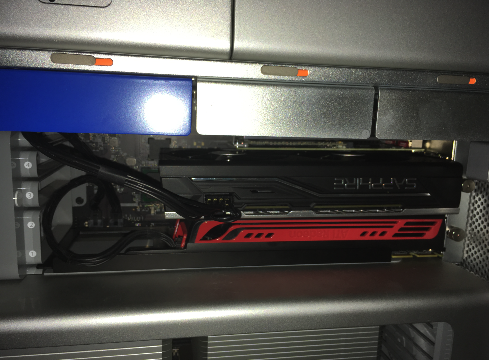

*** STOP using your RX580 like this, you should not power it by a single mini 6pin, that's way outside the mini 6pin's spec ***
1) Your RX580 is in slot 2
2) You can't replace the PULSE by the Nitro+. Nitro+ is a 2.2 slots wide card, not 2.0 slot. It will block the slot 4. And obviously you have a card in slot 4 right now. (And the Nitro+ will draw even more power from the 8pin)
3) You cMP is working correctly. AHT was built about 7 years before the RX580 exist. It's impossible to support the RX580. Unable to understand some sensor's reading is somehow normal.
4) Can you remove the 5770 and only use the RX580? If yes, the glitch during shutdown still there?
N.B. Your card seems works fine is just because you are lucky. And those benchmarks are not stressful enough. If you fun Furmark, your cMP should shutdown straight away due to overload the mini 6pin. Each mini 6pin can only practically deliver up to around 120W. And the PULSE RX580 can draw 150W from the 8pin under real high stress. Which will trigger the cMP's shutdown protection.
I will try that and let you know.
The graphical glitches (artifacts) are common in High Sierra with AMD GPU's. I've had several and it's VERY common. It's a driver issue, not a hardware issue AFAIK.

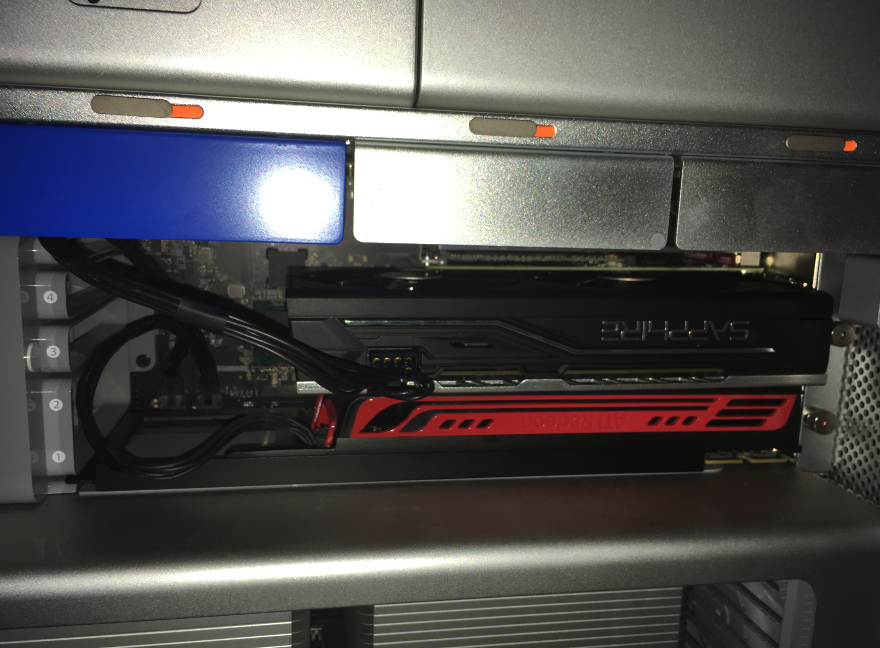

You need to power that RX580 card with a cable that connects both mini-6 pin power connectors on the logic board, to ONE 8-pin GPU connector. It's a Y cable. Use one unless you want to eventually ruin your MacPro.
I've also observed these glitches during shutdown. Sometimes I get a white block in the top left corner. Since the card runs great, I think it's a nonissue.
Absolutely! I've seen this exact glitch, come and go over the years with different macOS versions using AMD GPU's. I've even seen it in Linux when ATI (aka AMD) would release a new driver.
That's why I feel it's a driver quality issue. It never hurts a thing (except maybe your feelings) ;)

I received the GPU that way from the seller. It's an 8-pin connector not a 6-pin, unless I'm mistaken. or are you stating that it's a 6-pin on the board, not the cabling part going into the card?
Correct, I was talking about the "mini 6pin" (not normal 6pin anyway) that only exist on the cMP's logic board in your case.
Mini 6pin is rated up to 75W. Real world testing shows can deliver up to ~120W (already exceed the official limit). And your GPU's 8pin can pull 150W (way outside the mini 6pin can deliver).

This is a classic case of the blind leading the blind, the seller is wrong, and although under warranty if that's how he treats his machines for sale I sure wouldn't buy one from him. dual 6 pin mini to 8 pin is the requirement for the pulse RX580 1 single 6 pin to 8 is no good and if not now in the future it will all go wrong. and damage will be done to the logic board.
A good quality dual mini 6 pin to 8 pin is required and remove the 5770 you don't need it. I am surprised it hasn't damaged it already!
The only difference between the dual 6 pin to 8 pin y cable and dual 6 pin cables is the obvious. Your video card still needs external power to operate correctly. My GTX680 needs (2) 6 pin to 6 pin cables to operate. The single cable may be fine for everyday tasks but as stated if you start putting a load on it where it needs more power your machine will hopefully just shutdown, worst case as stated the extra current draw from the video card will cause your machine to burn up. The card draws about 185 watts. You get roughly 75 watts from the PCI buss. You need to make up the other wattage from the 6 pin connectors on the board. Each of those connectors are about 65 watts I think so. So using the setup you have now you are only supplying about 140 watts. If the card needs more it will try to draw more and overload not only the 6 pin cable but the PCI buss as well. Poof there goes your new machine. Just because it is working like it is doesn't make it right. Look up the power specs for that card. Just a quick look and from what I found it requires at least 185 watts of power.

I'm not trying to be rude guy, but seriously, I'm scared, worried and confused all at the same time. The machine has only been turned on a few times since I got it and I was mostly using the 5770 for video output while running the tests.
The whole reason is trying to explain how a system draws its power, just because it says 125w max does not mean its delivering 125w the idea is the spread the load over 2 mini 6 pins and PCIe.
the cable you bought is the right one. use only the RX580 you don't need the 5770 as well and enjoy your Mac.
Reactions: AmazingRobie
If you keep up with that demanding tone, you are unlikely to get any further help. These people are going out of their way to not only answer your questions, but patiently explain how it works so you can better understand how to create a stable system. You may be frustrated because it's complex, but please don't take it out on them.
Reactions: Macschrauber
You're right.
I'M SORRY TO EVERYONE.
My bad. I'm just tired and frustrated from reading contradictory statements and ending right back up where I started, without getting any definitive answers.
@AmazingRobie
The cable I linked to is safe.
If you want a safe plug-n-play solution, without doing your own research, then just get the cable and move on. It's really simple and not worth all the frustrations. This is a solid solution, no need to read and stress about all the other crap you're reading on various websites.
