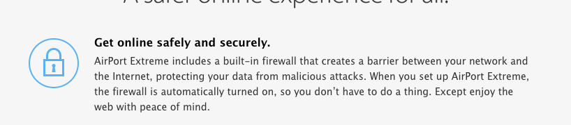

So then this is a lie? .. Pic attached
"Firewall" is a pretty generic term. AirPort definitely has one, it's just not configurable with a lot of options. Plenty adequate for me and for most users, but if you like a lot of customizable options with ports, etc. it doesn't do that.
Well, i have no hard facts how's this firewall implemented internally, but the NAT & Port Forwarding stuff has a side effect, that all ports that you haven't specifically re-routed on APX are closed and the router just drops everything sent to those destinations.
Any connection initiated from your LAN side is allowed to pass through, anything coming from WAN side is dropped by default.
