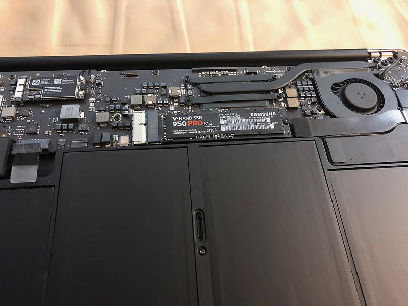

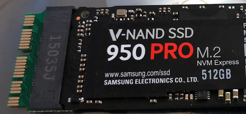

I installed a Samsung 950 PRO 512GB stick with this M.2 adapter, formatted it to APFS using Disk Utility software from my High Sierra install thumb drive then installed Mac OS High Sierra.
Here is the link to the adapter I used (in picture above): https://www.ebay.com/itm/112615200702?ul_noapp=true&afsrc=1&rmvSB=true

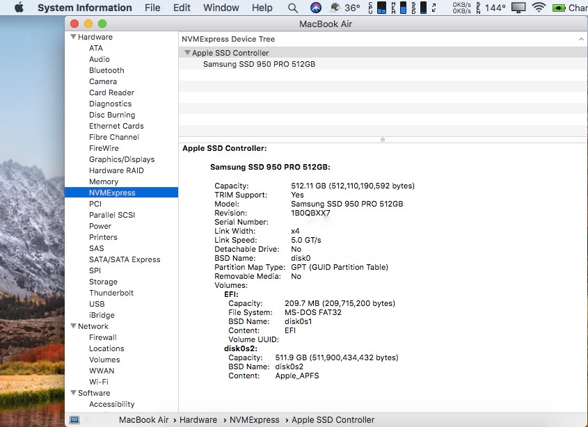

You can see in the picture below my M.2 adapter connected to my 950 PRO and installed and it does work.

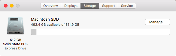

the picture above and below shows my new OS (High Sierra) recognizing my new M.2 drive.
sorry for the late response.... I've been on a business trip lately... planning to run benchmarks on the drive over the weekend but so far I have no issues at all since installing my Samsung 950 PRO M.2 drive... best thing I have done to my MacBook Air 🙂
